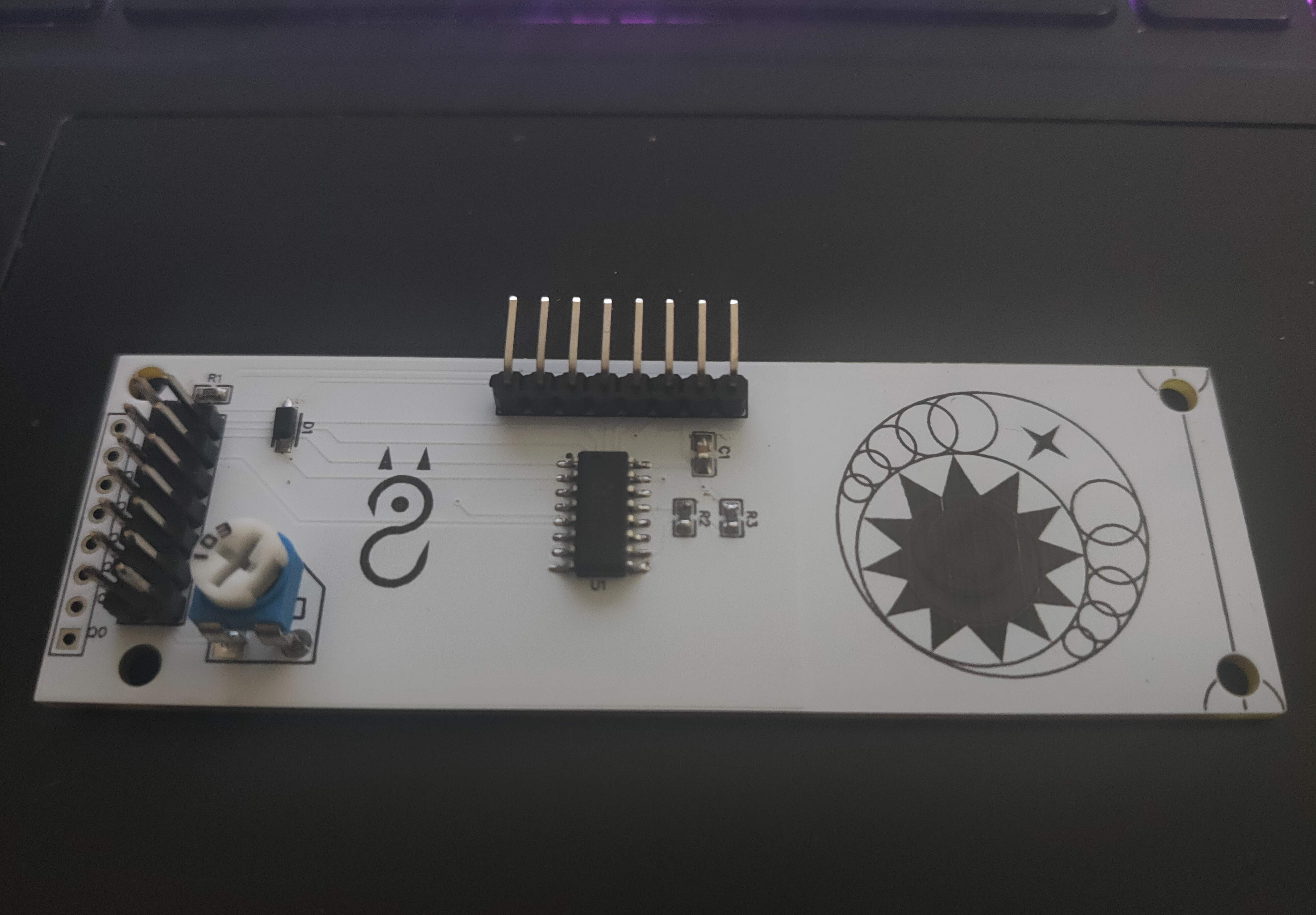

Use 595 to drive LCD1602
  • Supports minimum 3-wire drive, that is, 595 drive lines. When busy signal is required, it is increased to 4-wire driver.
  • LCD1602 operates in 4-bit mode, R/W and RS signals are output by 595 together, and EN signal is multiplexed with RCK of 595.
  • Allow LCD1602 to pull down the DB7 IO line to output the busy signal.
  • The connection with the LCD module uses double rows of 14pin pins, which are suitable for Taobao WD-C1602L module.
  • In addition to the IO line, there are three necessary connection lines: +5V, Gnd, and Vo. The Vo line is connected to a voltage divider for adjusting the LCD contrast.
  • Lead to Q7' of 595 for cascade connection.
LCD module information: http://www.hezkyden.cz/shop/lcd-modul-wintek-wd-c1602l/
The effect of putting them together: IMG20211105105650.jpg
