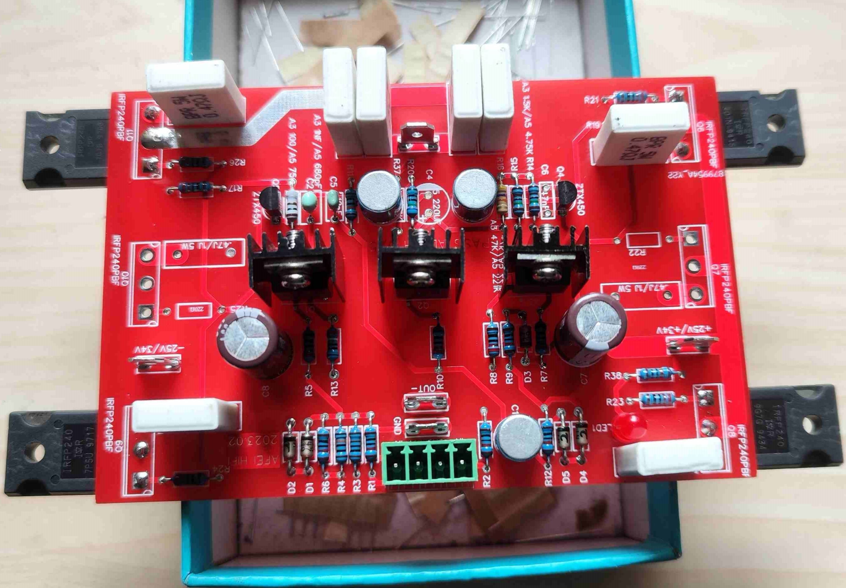

PASS ALEPH 3/5
Class A amplifiers generate huge amounts of heat, and the passive aluminum heat sink I used is 300*100*50mm. The power filtering part uses CRC or CLC circuit. A3 Class A output 30W. Mono power consumption is 100W.
