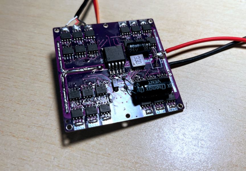

Modified from the ESC example on the STC official website:
Circuit:
1. Increase the number of channels, the circuit board layout is more compact, and it is suitable for the small cabin space of the Flying Drone
2. Replace the 7805 in the original circuit with the LM2596 switching power supply circuit, which solves the heating problem at 3S and improves the power efficiency
Software:
1. Improved the response speed
2. Added power-on music and protection of the throttle not being 0 when powering on
Provided an improved Keil C program
