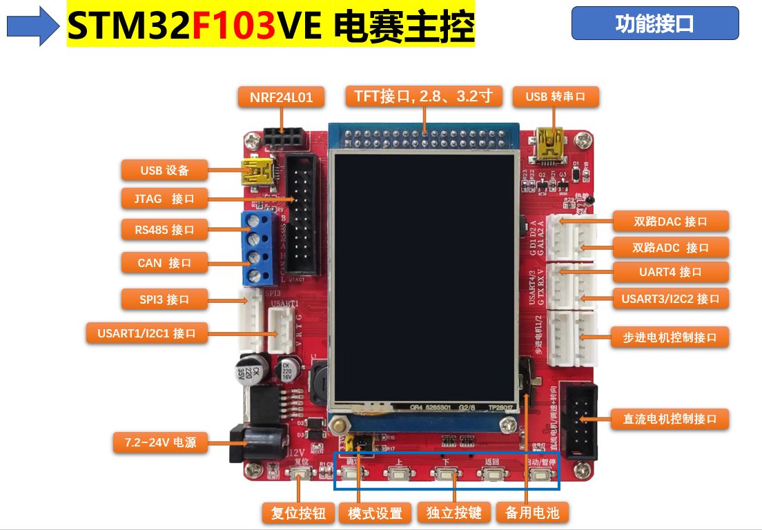

3. GK_F103VE_1.0 development board interface introduction 1. Minimum system design a. Main chip STM32F103VET6, with backup battery, convenient Do RTC (real-time clock) experiment;
          b. Isolate the digital ground from the analog ground, use TL31 to design a 2.5V reference voltage, supply VREF, ADC/DAC reference voltage 2.5V;
          c. High-speed clock 8M, low-speed clock 32.768;
          d. Design 6 Pin mode switching interface is convenient for setting the startup mode;
          e. The download uses the standard 20-pin JTAG interface, which leads to PA13, PA14, PA15, PB3, and PB4, and can be downloaded by JTAG and SWD;
          f. The mini USB interface is designed to realize USB MSC, HID and other slave devices. 2. LED interface circuit: Design 2 LEDs, connect the common anode to 3.3V, and light up at low level. LED is the best carrier for entry-level GPIO operations, and it is also an indicator of the operating status of electronic equipment.
3. The TF card interface
       STM32F103VET6 comes with SDIO peripherals, which is very convenient for SD card operation. The hardware design uses a TF card holder, and the communication interface uses a 4-bit data width.
SDIO+FatFs can realize the reading and writing operations of files in the TF card to meet the system's demand for large-capacity files, such as font files and picture files, which we can
load through the memory card.
4. Button interface circuit: Design 5-way button input, independent button connection mode, configure GPIO with pull-up input, and input low level when the button is pressed. Buttons are important
input .
5. Buzzer and thermistor interface circuit The buzzer is driven by a transistor and is active at low level. The buzzer is an essential prompt device on electronic equipment. The thermistor is
a carrier used to experiment with MCU AD conversion. It can be used to verify the ADC acquisition results and measure the ambient temperature at the same time.
6. Serial communication interface circuit STM32F103VET6 has 5 serial port outputs, USART2 is used as RS485 interface output, and MAX485 is used as a level conversion interface chip. USART1, USART3 and
UART4 TTL level interfaces, the corresponding pins are FT (5V voltage resistant), the pin interface power supply is 5V, which facilitates the expansion of functional modules, and the input pins are connected to a pull-up circuit to
stabilize the input level. The USART1 and USART3 pins can also be mapped to I2C1 and I2C2, so the two interfaces are USART and I2C multiplexed. 7. SPI interface circuit SPI is the main interface for communication between MCU and peripheral function chips and modules. The SPI interface is mainly designed to facilitate the expansion of chips and modules with corresponding interfaces. The corresponding I/Os (PA15,
PB3, PB4, PB5) are all FT tubes. pin, the interface power supply uses 5V to enhance scalability. SPI3 conflicts with JTAG debugging interface I/O, so JTAG debugging cannot
be used .
8. The ADC/DAC interface circuit
       STM32F103VET6 has two DAC outputs, and the corresponding interface pins are PA4 and PA5; two ADC inputs, and the corresponding interface pins are PA0 and PA1. The reference
voltage VREF of the analog circuit is 2.5V, the DAC output voltage is adjustable from 0 to 2.5V, the ADC can collect the voltage range from 0 to 2.5V, and the interface power supply voltage is analog 3.3V. At the same time, a protection diode is connected in series
to prevent external high voltage from flowing back into the development board. 3.3V power network. When designing analog circuits, ADC/DAC is an important data exchange interface.
9. DC motor control interface circuit: Design a dual-channel DC motor control and speed regulation interface, which requires an external drive board. Each motor uses 3 I/O controls, 1 speed regulation, and 2 control directions. The interface is directly
adapted to Taobao DC. Motor drive module, see picture below. The 6 I/Os of the interface are complementary outputs of TIM1 and can output SPWM signals.
10. Stepper motor control interface circuit design dual-channel stepper motor control and speed regulation interface. Each motor uses 3 I/O controls, 1 speed regulation, 1 control direction, and 1 enable. An external driver board is required. Drive
stepper motor, dual stepper motor drive interface can complete the control of two-dimensional pan/tilt.
11. TFT interface circuit STM32F103VET6 has an FSMC (variable static memory controller) interface. The TFT interface adopts the 8080 interface and can be driven directly by the FSMC interface.
The touch chip communication is connected using SPI2 and shares a common SPI interface with W25Q128 through chip selection time sharing. operate. 12. SPI FLASH interface circuit The development board is designed with W25Q128 static memory chip and 16M SPI FLASH, which can experiment with SPI communication, static storage, file system, making U disk, etc.
The communication interface uses SPI2, and SPI2 is also used in TFT touch chip communication. Communication between different chips is achieved through chip selection. The W25Q128 chip selection is PA6. 13. CAN interface circuit The CAN interface is a typical peripheral of the STM32 series MCU. Development based on STM32CubeMX makes driver design simple. It is
also very important to experiment with this interface on the development board. CAN uses TJA1050 level conversion chip. 14. Automatic download interface circuit The development board design is a USB to serial port interface. The chip uses CH340C. The RTS and DTR pins are used to control BOOT0 and RST to realize automatic download of the serial port program.
If there is no STLINK or JTAG debugger, USB MINI can be used. Interface cable for program download. 15. Wireless communication interface circuit The
          wireless communication interface uses the NRF24L01 module, the SPI communication interface, and the SPI3 interface to realize wireless communication between development boards.
16. Power supply
         circuit The power supply circuit uses the LM2596-5.0 DC/DC chip to step down the voltage. The power supply voltage of the development board is 7.2~24V. Use AMS1117-3.3A to convert the 3.3V power supply. Use
an inductor and 0Ω resistor to isolate the digital ground and analog ground.
