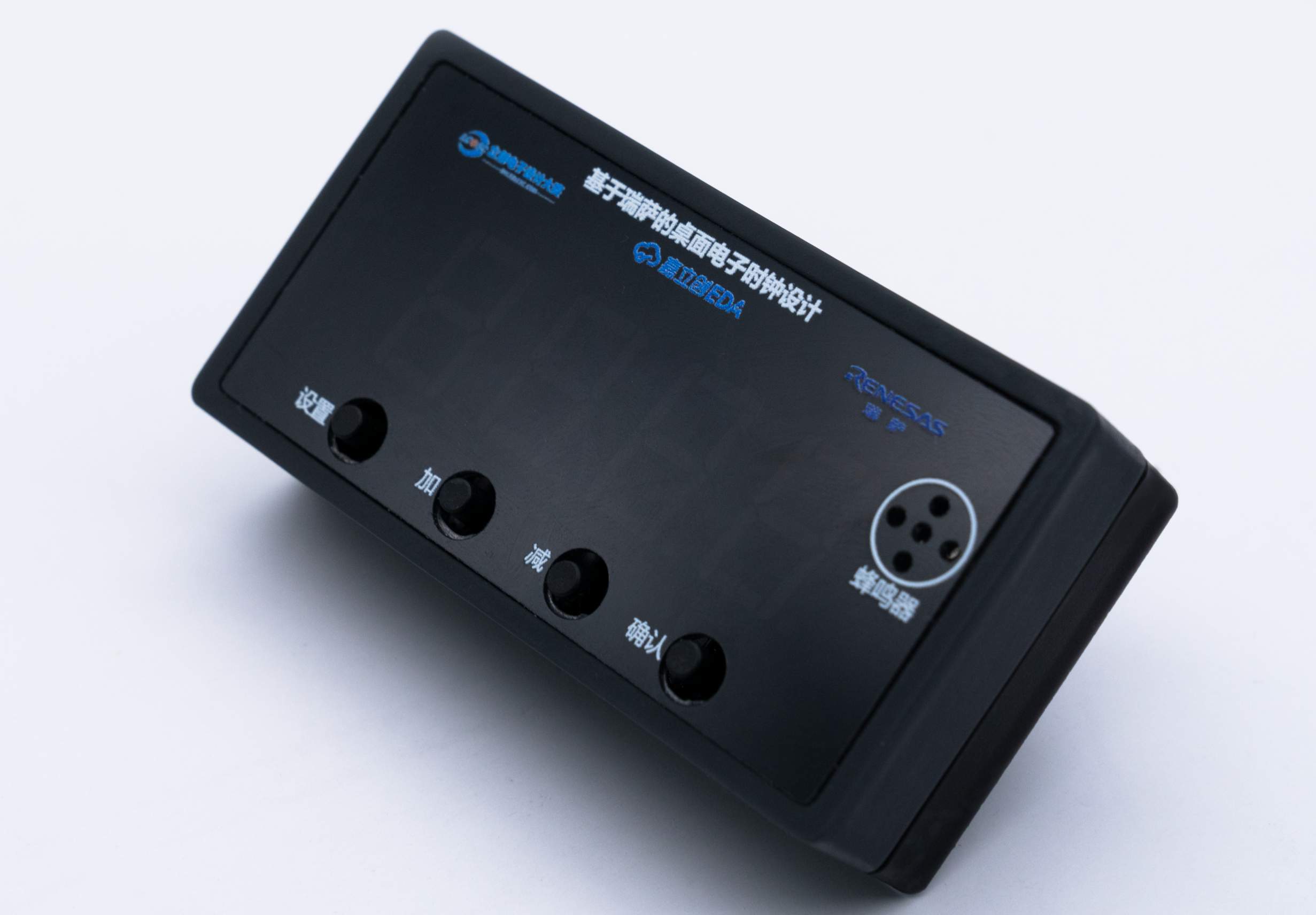

1. Project Introduction
      The desktop electronic clock is designed based on the R7FA2E1A72DFL chip. The time and temperature are displayed through a four-digit 0.56-inch common cathode digital tube. The DHT11 temperature and humidity sensor is used to collect the ambient temperature and humidity. The reset button, serial port circuit, and SWD download circuit are all led out for easy download and debugging.
II. Onboard resources
Figure 2-1 Front view of desktop electronic clock resources
Figure 2-2 Back view of desktop electronic clock resources
1. Main control chip: R7FA2E1A72DFL;
2. Power interface: TYPE-C, 2Pin plug-in;
3. LED: one power indicator light, one charging status indicator light;
4. Buttons: one reset button, one BOOT button, four function buttons;
5. Debug interface: SWD download debug interface, serial port download debug interface, both use 2.54 pin header interface for lead-out;
6. Peripherals: one 0.56-inch common cathode digital tube, one DHT11 temperature and humidity sensor, one passive buzzer;
