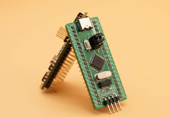

1. Project Introduction
    HK32F103C8T6 has a built-in high-performance ARM Cortex-M3 core, rich peripheral configuration, low price, ultra-low power consumption, and high cost performance. Therefore, referring to the STM32F103C8T6 minimum system, a compatible Hangshun HK32F103C8T6 minimum system is designed.
2. Onboard resources
Figure 2-1 HK32F103C8T6 core board resource diagram Main
control chip: HK32F103C8T6, LQFP-48;
Power interface: TYPE C, plug-in 2Pin;
LED display: 1 power indicator, 1 status display light;
Startup mode: BOOT mode configuration, 2x3Pin straight pin header;
Debug interface: SWD burning method, 4Pin bent pin header;
External pins: lead out programmable IO port, 2 1x20Pin straight pin headers;
3. Advantages and characteristics
Figure 3-1 HK32F103C8T6 core board size diagram
The board is small in appearance, with a size of only 53.3mm*22.9mm (2100mil*900mil);
compatible with STM32F103C8T6 and other mainstream F103 core board pinouts;
cheap, ultra-low power consumption, rich functional pins, high cost performance;
using Jiali Chuang high-quality PCB and genuine components to ensure product quality;

Figure 6-3-1 PCBA physical picture - top surface
Figure 6-3-2 PCBA physical picture - bottom surface
Figure 6-4 The following points
should be noted when debugging the 3D renderings :
