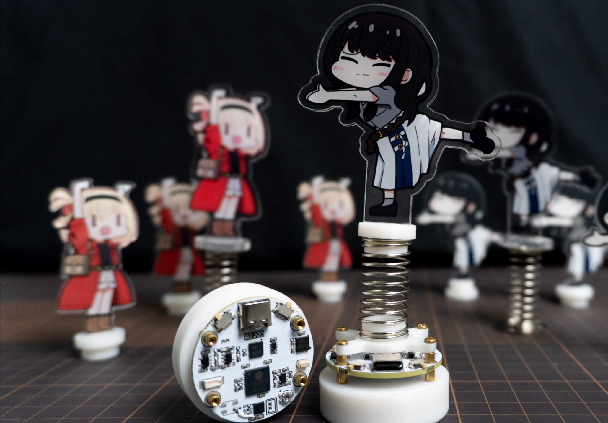

![46a732d9a2c8dd91c9214a7d636a026.jpg] This is a voice base designed for Takina and Chizuki rocking music. It plays the corresponding sound source after detecting vibration, and also supports connecting to Bluetooth to play music.
The right switch controls the power supply, and the left switch switches the sound source.

![SW 泷奈.png] **Because ESP32 generates serious heat when connected to Bluetooth to play music, the PCB is externally placed and connected to the printed part with four copper pillars, of which the two copper pillars close to Type C are connected to the battery, and the other two are connected to the speaker. In
addition to the battery, speaker, main control board, spring, and character stand, the other four are 3D printed parts, all of which are interference fit. **
