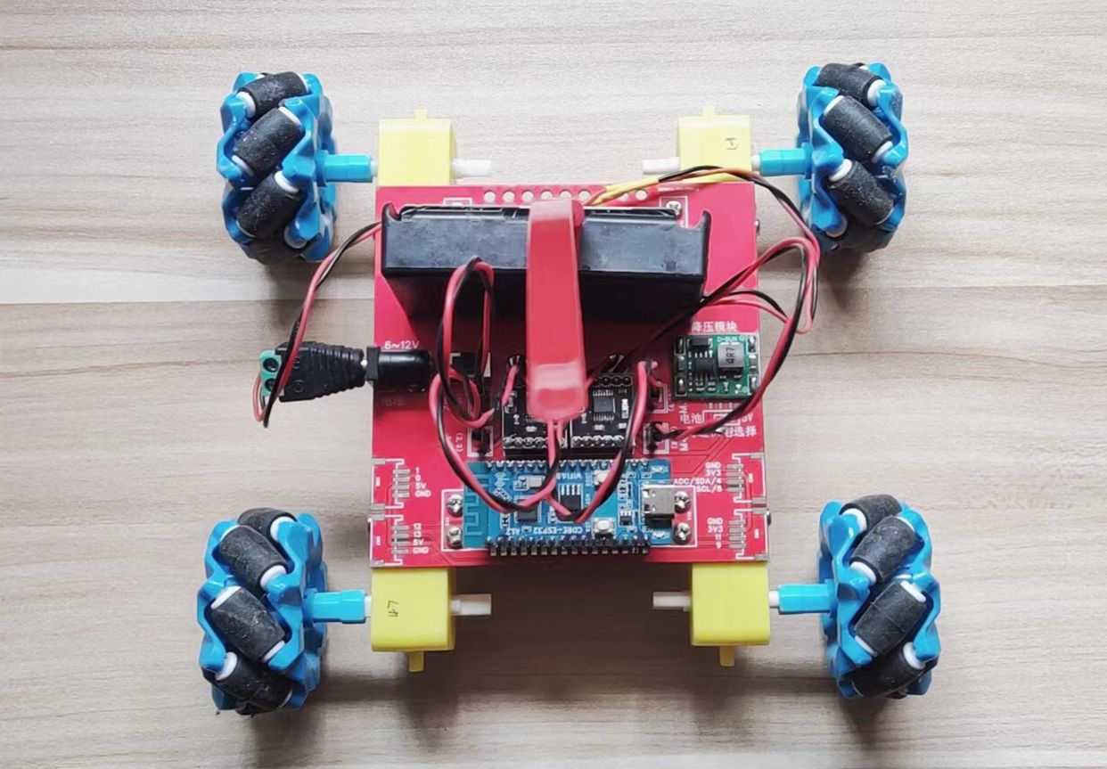

The remote Mai Lun car based on the Hezhou ESP32-C3 development board is both a car chassis and a development board with onboard drv8833 motor drive and MP1584 step-down module.
The car is powered by a 7.4V battery pack or a 12V battery pack and leads to 4 sets of PH2.0 terminal interfaces for convenience There are peripheral installation holes at the front end for connecting line patrol, ultrasonic, lanterns, screens and other peripherals. The hole spacing is 5MM and the hole spacing at both ends is 40MM. It is compatible with Lego holes. You can use screws to fix a Lego piece to expand the Lego bricks.
Development environment: mixly (Misiqi) graphical programming software
IoT platform: mixio, mixly supporting IoT platform
remote control: mixio web page or Android APP (developed based on APPinventor2)
The car is positioned as an IoT car, so in addition to all the cars With basic gameplay and IoT remote control gameplay, you can also use your imagination to realize almost all IoT applications.
