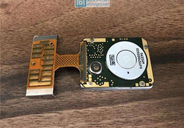

Teach you how to change the Nokia N91 mechanical hard drive into a USB flash drive. The Nokia N91 is the only mobile phone with a mechanical hard drive. The hard drive model MK4001MTD 4GB has an operating voltage of 3V and an operating current of 0.5A. It is produced by Toshiba and follows the MMC protocol. Without further ado, Let's start directly. First prepare an N91 hard drive, which must be easy to use. MMC protocol:

The picture above shows the position of the hard disk of the N91 machine compared with the gold finger. You can see the same pins, but after careful observation, you find that the positions of the wide surface and the MMC card notch are somewhat different. At this time, it needs to be cut.
The picture above shows the position to be cut. Do not cut the red line to the PFC flexible cable. Feel free to cut the green line. (I have tried cutting it and it still works well.) Although the trace can be cut, it is ground There are traces in other locations, so it has no effect. Card reader chip selection: GL827, because it supports MMC protocol, SD protocol, etc. If you want to know more, you can find the official parameter manual.
