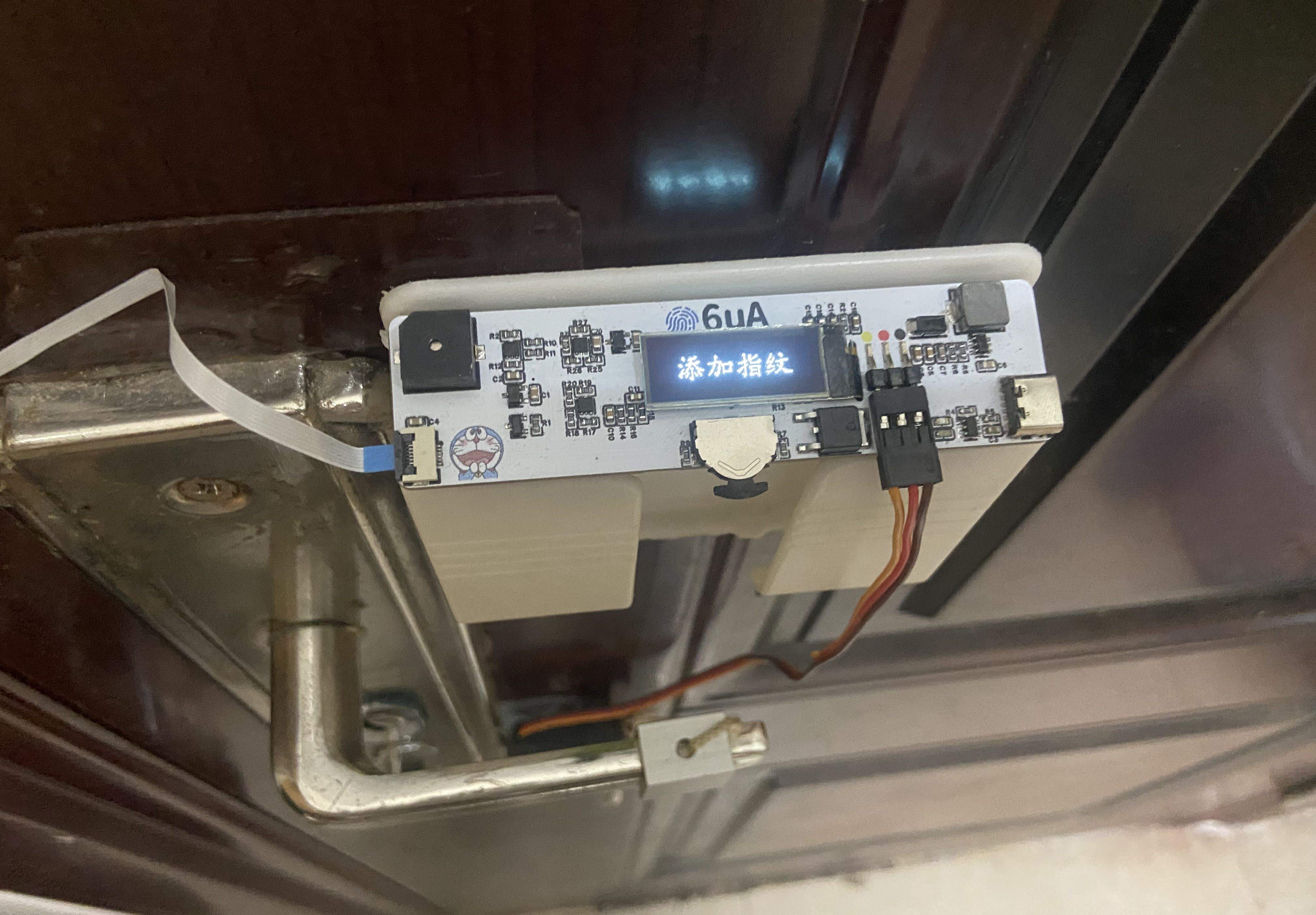

A small, low-power universal fingerprint lock designed based on the ultra-low-power single-chip microcomputer MSP430 solves the embarrassment of forgetting to bring keys when going out of the dormitory. The standby current is 6uA, and one battery can be used for a year without any problems! No need to disassemble the door lock for direct installation, simple and convenient, suitable for all types of door locks.
Main control: TI Texas Instruments' MSP430G2553 ultra-low-power single-chip microcomputer
Fingerprint model: AS608
Servo model: sg90 or MG996R
Battery model: Lishen 18650 power battery (5C) or 21700 General

The main functions and UI design have been completed on the development board, and the Jiali Chuang PCB proofing verification is being prepared!
Design principle:
The standby current measured by the low power analyzer is only 6uA.
1. The main control adopts MSP430G2553 to achieve ultra-low power control. When the fingerprint recognition is successful, the sx1308 boost chip is used to increase the voltage of the 18650 battery to 5V to drive the servo to open the door.
2. The button trigger task uses different buttons to add, delete fingerprints, turn on and off the buzzer and screen, and other functions.
3. The fingerprint drive circuit allows the main control IC and the fingerprint module to communicate via serial port.
