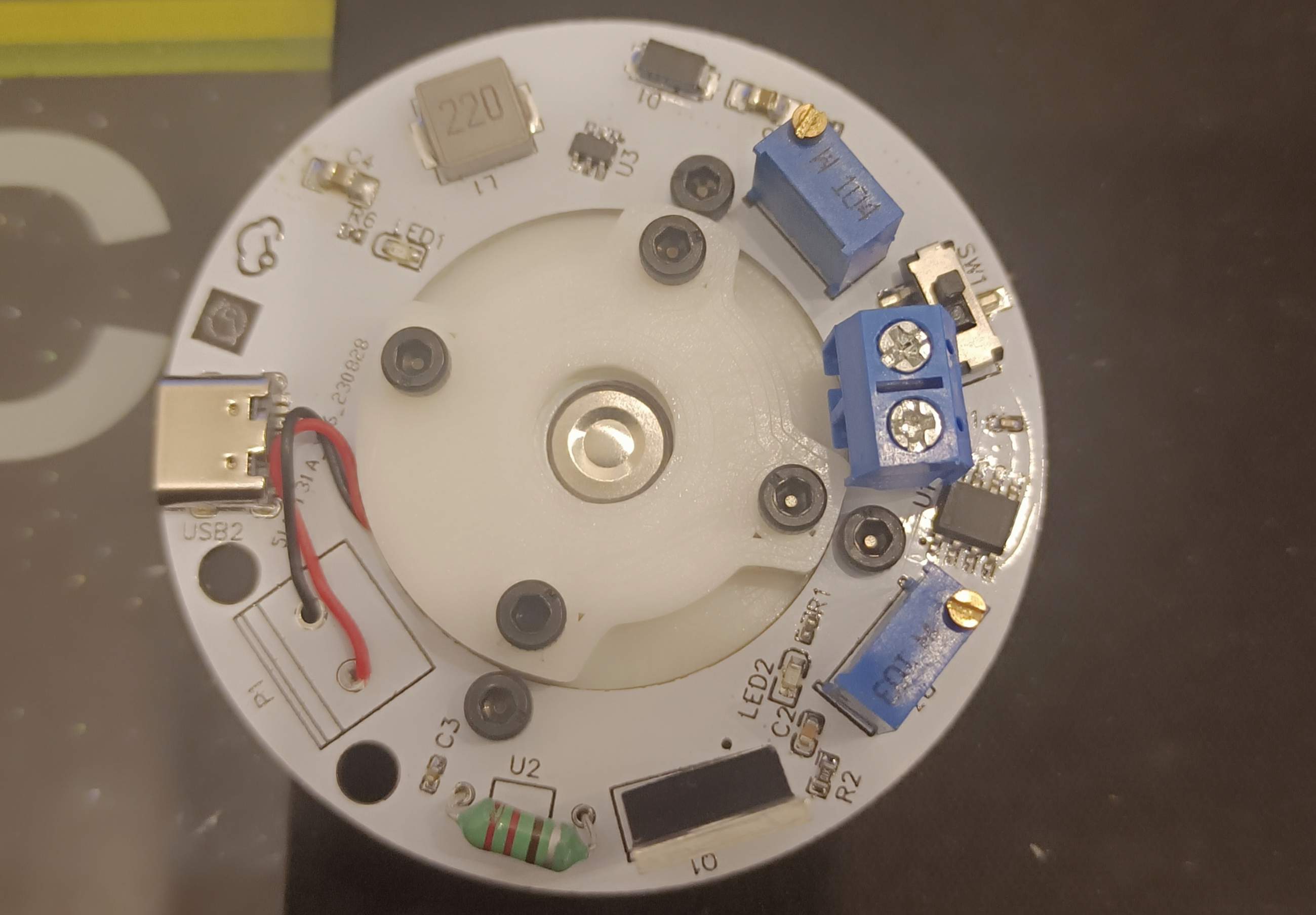

atomizer humidifier
MT3608.NE555 .108KHz piezoelectric ceramic, the potentiometer can be converted into a fixed resistor, and can be temporarily used as an adjustable boost module. 5V.TPYPE-C input, used directly on mineral water bottles. It is now known that the printed parts are suitable for Nongfu Spring, Master Kong, and Yunnan Spring mineral water bottles. No casing is designed, and the exposed PCB has a different aesthetic. Not counting the PCB cost of about 10 yuan. After finishing it, I discovered that the finished product on Taobao is only 8 yuan and comes with free shipping. The modeling only introduces the latter two types of leak-proof ones, otherwise the leakage will burn the board. Feedback is welcome in the comment area.
