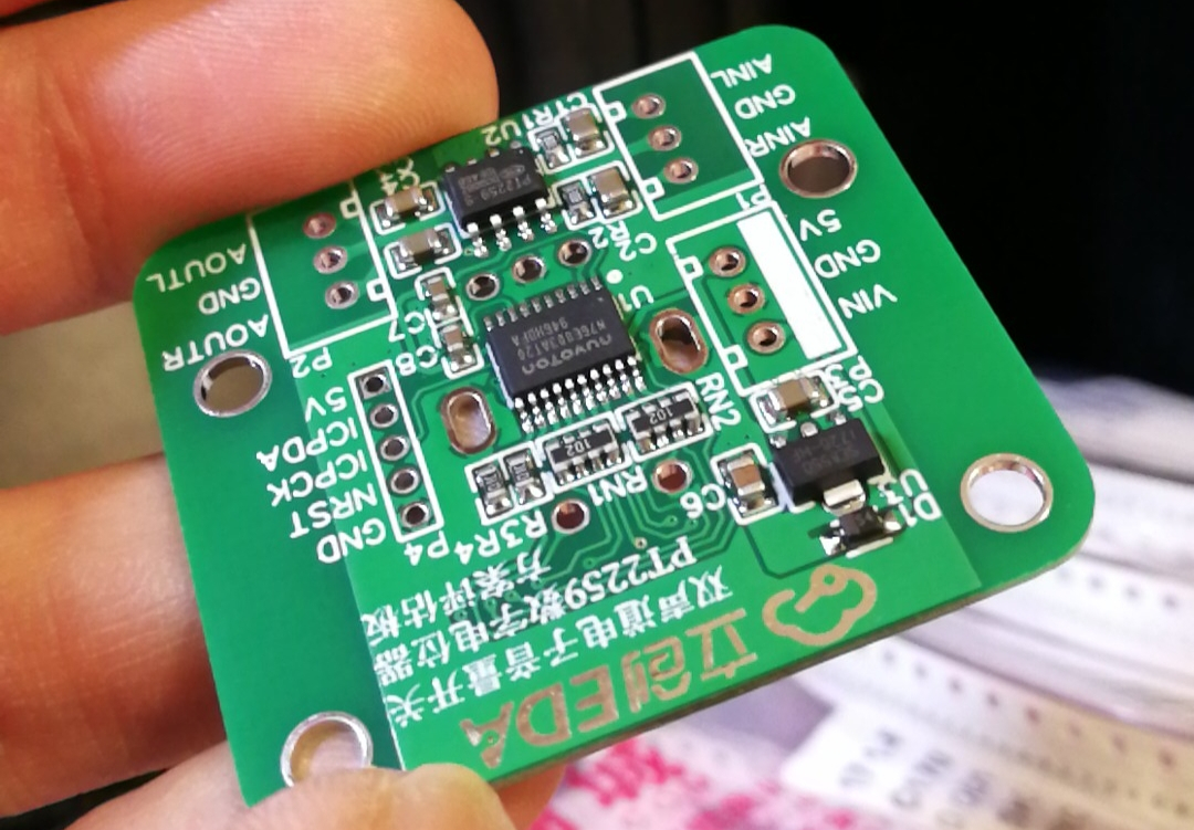

  • This project is used to verify the solution verification board design of the video and audio interface chip PT2259-S of Lichuang Mall .
  • This project is a sample project for the Solicitation Order for Lichuang EDA open source hardware platform solution verification module .
  • This design is an electronic volume control scheme based on N76E003AT20 microcontroller controlling PT2259-S.
  • It consists of a microcontroller, an electronic volume chip, an encoder, a 5-level LED indicator, a two-color status LED, and other components.
  • Realize the function of audio signal input and output volume adjustment through the encoder. Get rid of the rustling sound caused by ordinary potentiometers.
  • Expected functions:
  • When powering on for the first time, it is in standby state (to simplify the operation, there is no shutdown state, standby means shutdown), L6-L2 does not light up, and L1 lights up with a red breathing light.
  • Press the middle button of the encoder once to power on, L1 turns to solid green, and the preset volume is read at the same time. The preset volume flashes 3 times in 1 second, and the volume increases from 0 to preset L6 in the next 1 second. L2 increases steplessly to correspond to the volume scale.
  • In the power-on state, press the middle button of the encoder once to enter standby (power off), save the current volume, L1 turns into a red breathing light, and the output volume is directly turned off to obtain the fastest muting speed. Within 1 second, L6-L2 decreases steplessly from the corresponding volume scale to completely extinguished.
  • When the volume is turned on and the volume is rotated to the lowest 1-step volume (no 0 volume at boot, to be determined), L1 green light flashes, L6 maintains the corresponding 1-step volume brightness, and L5-L2 are all off.
  • When the volume is turned on and the volume is rotated to the highest volume, the L1 red light flashes and L6-L2 are all on.
  • The highest, lowest, and one more rotation are locked, and the two functions are automatically activated. To release, you need to rotate 1 grid in the opposite direction to prevent the encoder from accidentally triggering. This ensures normal operation of the function without affecting the actual operation.
