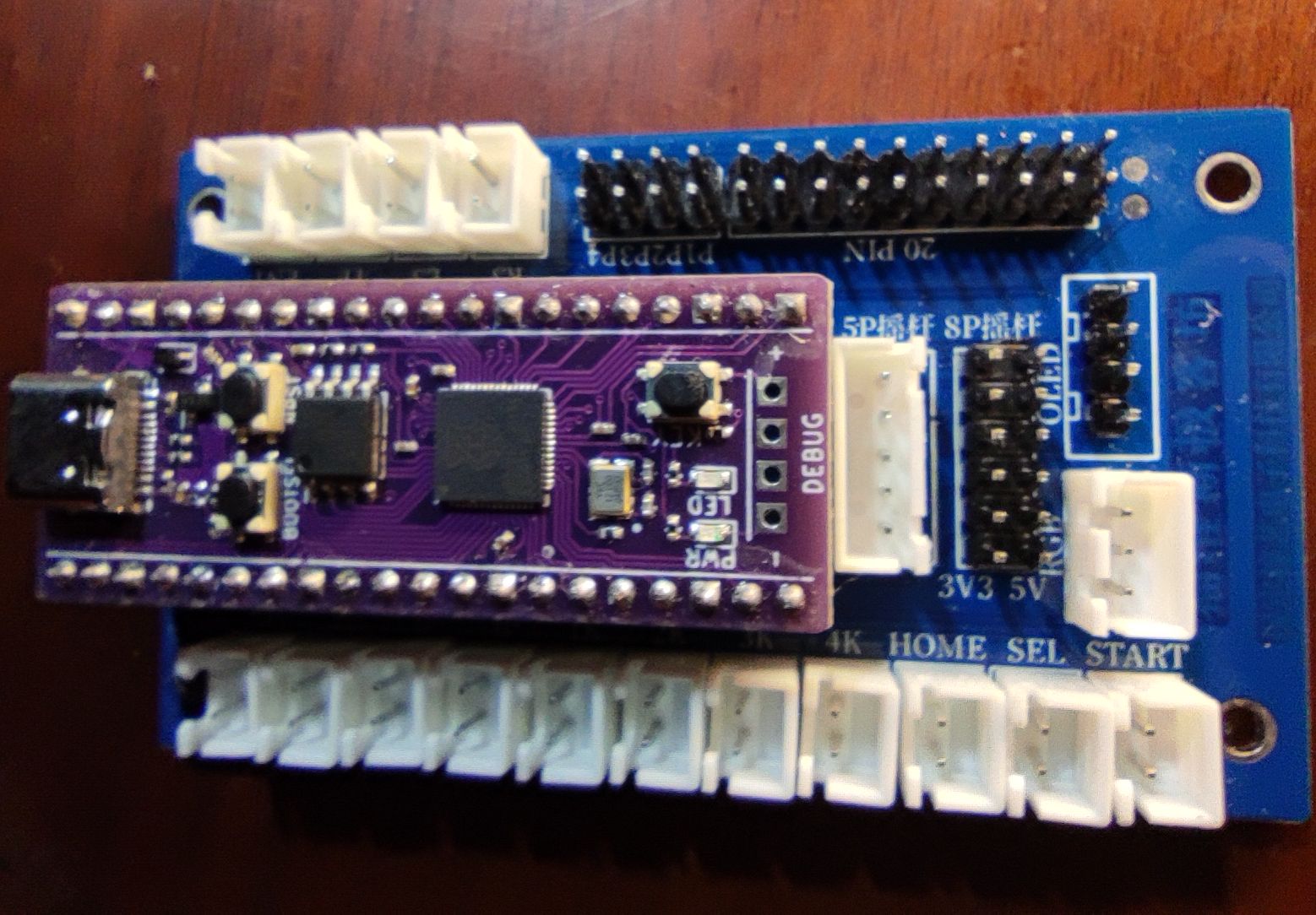

The burst test was not successful. I don't know if it is due to the firmware. In addition, since I don't have an OLED screen, the OLED display has not been tested. If you have the conditions, please help test it. Thank you.
Pico joystick chip usage instructions
Introduction
This chip is modified according to the open source project FightingBoard
Firmware burning
1. Download the latest firmware from https://github.com/FeralAI/GP2040/releases;
2. Press the BOOTSEL button on the PICO and plug the data cable into the computer;
3. A removable disk named RPI-RP2 appears on the computer. Copy the downloaded uf2 file to the disk. After completion, the pico will automatically restart, and the computer will recognize it as a game controller.

I2C PIN is a 128x64 monochrome display interface driven by SSD1306, SH1106 or SH1107.
Advanced Configuration
PICO has a built-in configuration application that needs to be accessed from a computer. Follow the steps below:
1. Press and hold the joystick START and plug it into the computer.
2. Open the browser and enter http://192.168.7.1 in the address bar.
In this interface, you can adjust the joystick settings, configure the RGB LED, reset the joystick, and other operations. When you enter the advanced configuration, it will automatically upgrade to the latest firmware.
The button interface corresponds to the button name of each mode. Refer to the table
