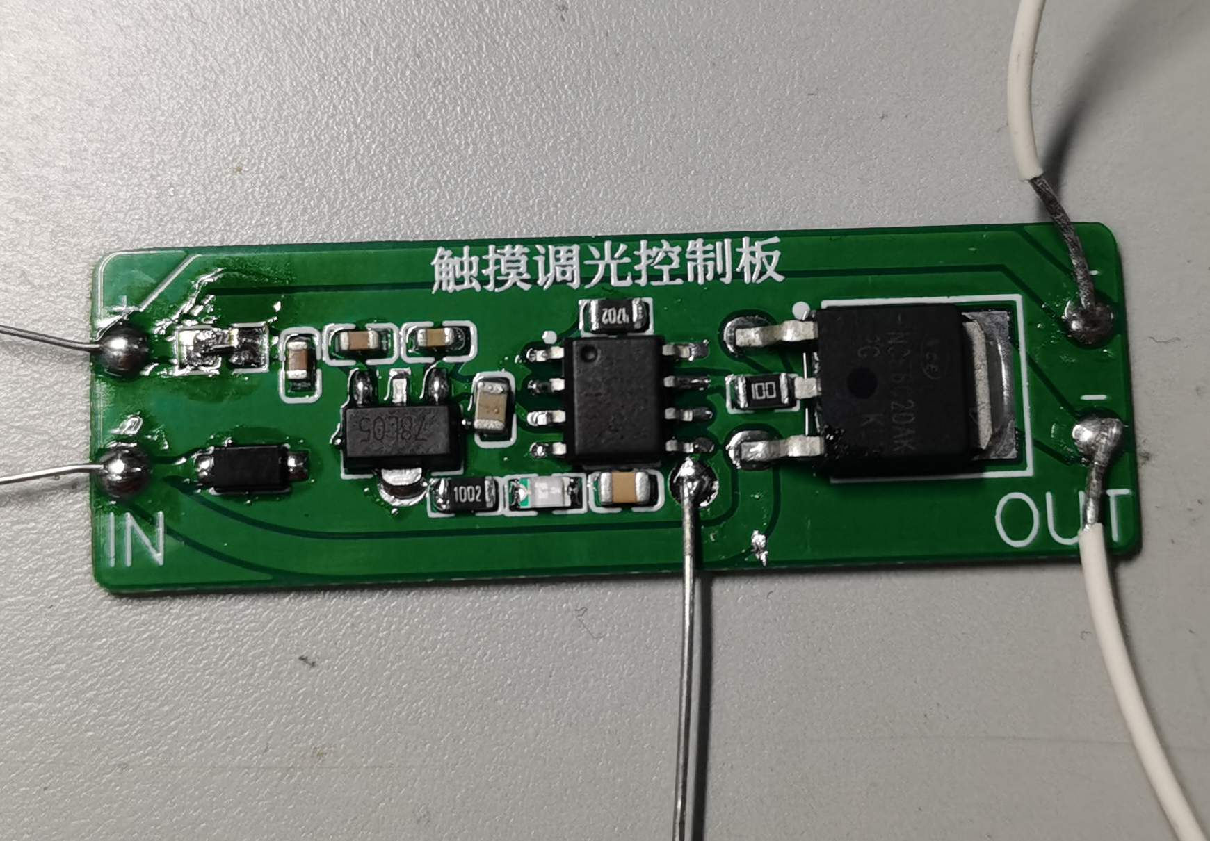

touch desk lamp
Touch pwm dimming module using 8022W chip.
Thanks again to Jialichuang and Lichuang eda, which makes the drawing board and board making very simple and convenient. The pcb is very compact
     using Lichuang eda to draw the board . The touch chip is powered by 2.4-5.5v. 78l05 is used here. Linear voltage regulator tube, because 78l05 generates a lot of heat under a large voltage difference, a voltage dividing resistor is added. My COB lamp bead is more than 30 volts. The measured working current of the touch chip is about 4ma. The voltage dividing resistor is about 4.7k. Oh, after the actual measured voltage division, the voltage regulator tube input is 11 volts, and it does not generate heat! Here you need to match the resistance value according to the power supply voltage, R=(vcc-5)/0.004. The picture below shows the chip function settings. The chip technical manual has been included in the attachment.
