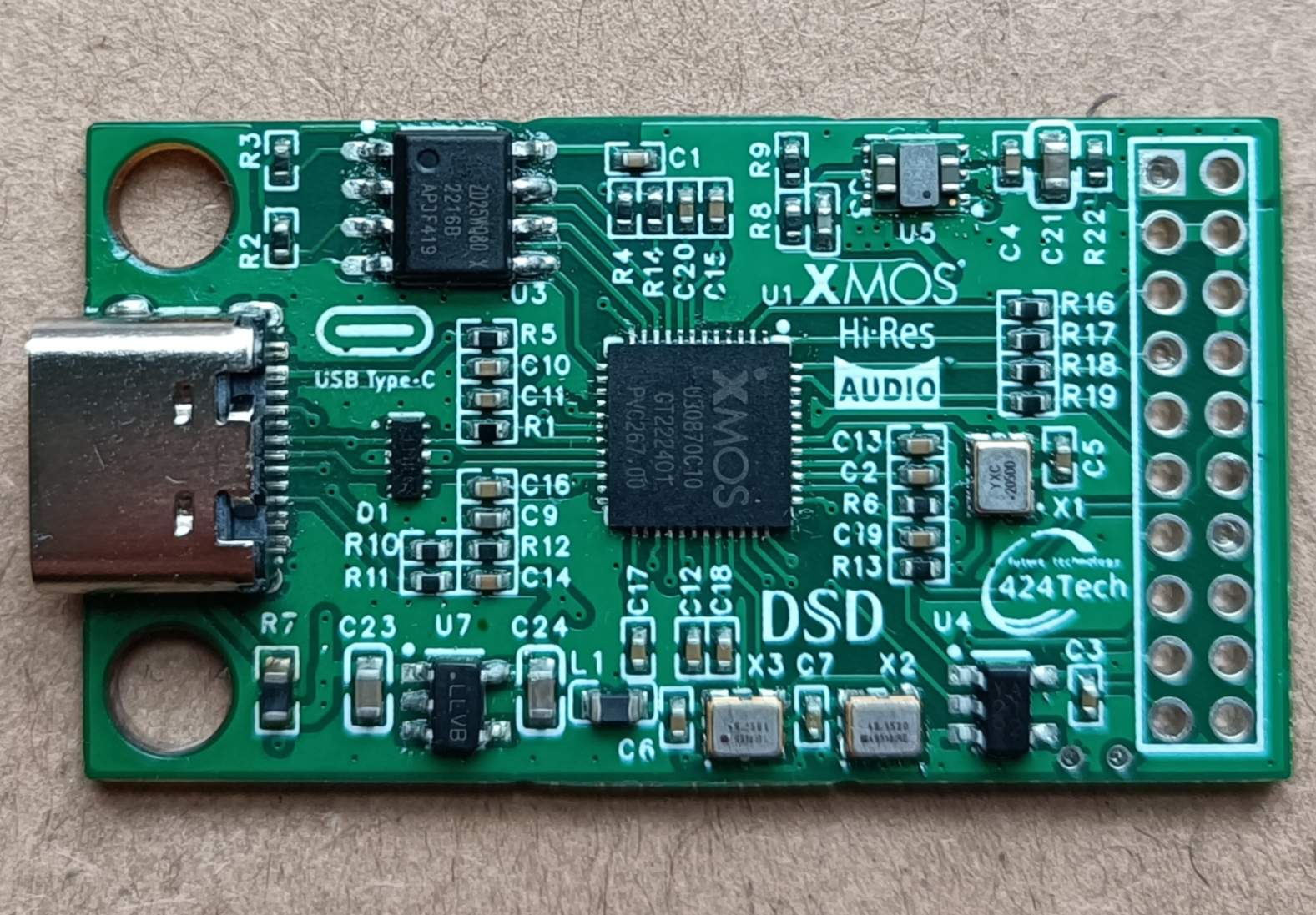

This is a USB-to-I2S audio interface made with XMOS XU208. It supports 32bit bit depth/192kHz sampling rate, and theoretically supports up to PCM 32bit/768kHz and DSD512 modes (I was lazy and didn’t do it, I have to modify the firmware). Using a 4-layer board process and measuring 4CM×2.2CM, it should be the smallest digital interface currently available.
Since most of the Amanero boards sold on the market are not only large in area, but also use a bulky USB Type-B interface, I wanted to make a small C-port digital interface myself. The reason why I chose XMOS is that only the information on this chip is open source. The Italian solution is not open source. CMedia’s CM6631A solution is too old, and the two BOM areas are relatively large. Saivtech’s SA9227 is also not open source. As for ComTrue’s CT7601 The use of external clocks is not supported.
There are few examples of successful production on the Internet, and the Amanero solution has now taken over the spotlight. However, overall, XMOS's developability is quite strong. All the information on this chip is officially open source, and there are even step-by-step tutorials. The schematic diagram refers to the structure of various USB digital interfaces on the market and is designed in the form of a daughter card to facilitate connection with different boards.
Because it is used with my digital Class D amplifier ([Hi-Res] Class D digital amplifier based on TAS5825M), the digital interface I made only supports 32bit/192kHz PCM and does not support DSD mode, but in theory, modifying the firmware can Support can be achieved. If necessary, you can also add an audio input port, which is something that most digital interfaces on the market cannot do.
Schematic description:
The main chip uses the QFN48 package XU208-128-QF48-C10, which is the smallest digital interface chip currently available. It has built-in high-speed USB2.0 PHY to simplify circuit design.
The chip requires an IO voltage of 3.3V and a core voltage of 1.0V for power supply. The 3.3V voltage is obtained from the LDO, and the core voltage uses a DC-DC solution to reduce system power consumption.
The matching clock is Accusilicon's AS318B in 2520 package. It is affordable and has reliable performance. The key is that it is small enough and perfectly meets the requirements.
The power-on reset (POR) circuit uses NCP303LSN09T1G, but since Lichuang is out of stock, we use BU4209G TR instead. If you have a better alternative, please tell me in the comments.
The firmware uses SPI NOR Flash for storage. The model is not important. Most of them are universal. I chose the cheap and large ZD25WQ80BTIGT with 8Mbit capacity. However, according to actual measurements, my firmware is only 27kb. In other words, you can replace it with 512Kbit Flash. It can also work. Note that XU208 supports SPI and QSPI flash. The two different protocols of flash have requirements on wiring methods and software codes. You need to refer to the manual and routines in detail.
The output uses a 2.0mm 2×10pin pin header, but I still feel unsatisfied. If there is a better connection method, please tell me in the comment area.

Problems with the first version:
1. USB reverse connection is not recognized. It may be due to the impedance of the DP/DN line. It has been modified, but whether it can be used remains to be verified.
2. The two mechanical holes were opened to 4mm. They were originally designed to be 3mm, but have been corrected.
Things that you may need to modify:
1. Replacing the 2.0mm pin header at the output with a 2.54mm pin may be more in line with public needs, or if there is a better way to communicate in the comment area.
2. If you do not want to draw power from USB, but provide additional power by yourself, just disconnect R7 in the picture, and then supply power to the VIN end of the pin header (do not exceed 5V).
