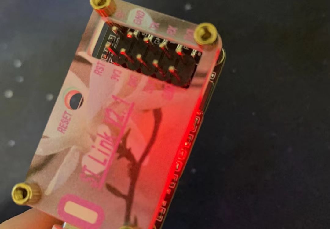

## ***Physical Verification***
![1one.jpg] ![Five.jpg]

## ***Summary***
### 1. The board processing cost is high, and hand welding is difficult, but the size is really small.
### 2. The connection holes between the motherboard, panel, and adapter board are easy to get soldered during soldering. Then screw it in and it will be a little crooked.
### 3. Each fixed size was not fully considered in the early stage and will not affect the use, but you will need to re-purchase the connecting parts. The initial design was to make a complete product, and a full set of materials, outer packaging, copper pillars, terminals, and connections were purchased, so the overall cost was quite high.
### 4. The first design of the panel was not very good.
## Successful, but the cost is quite high.
