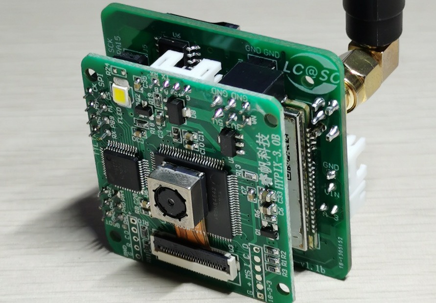

* 5. Upload project pictures 5.1. Print the competition logo picture on the PCB, if not, it will be deemed as giving up the competition
