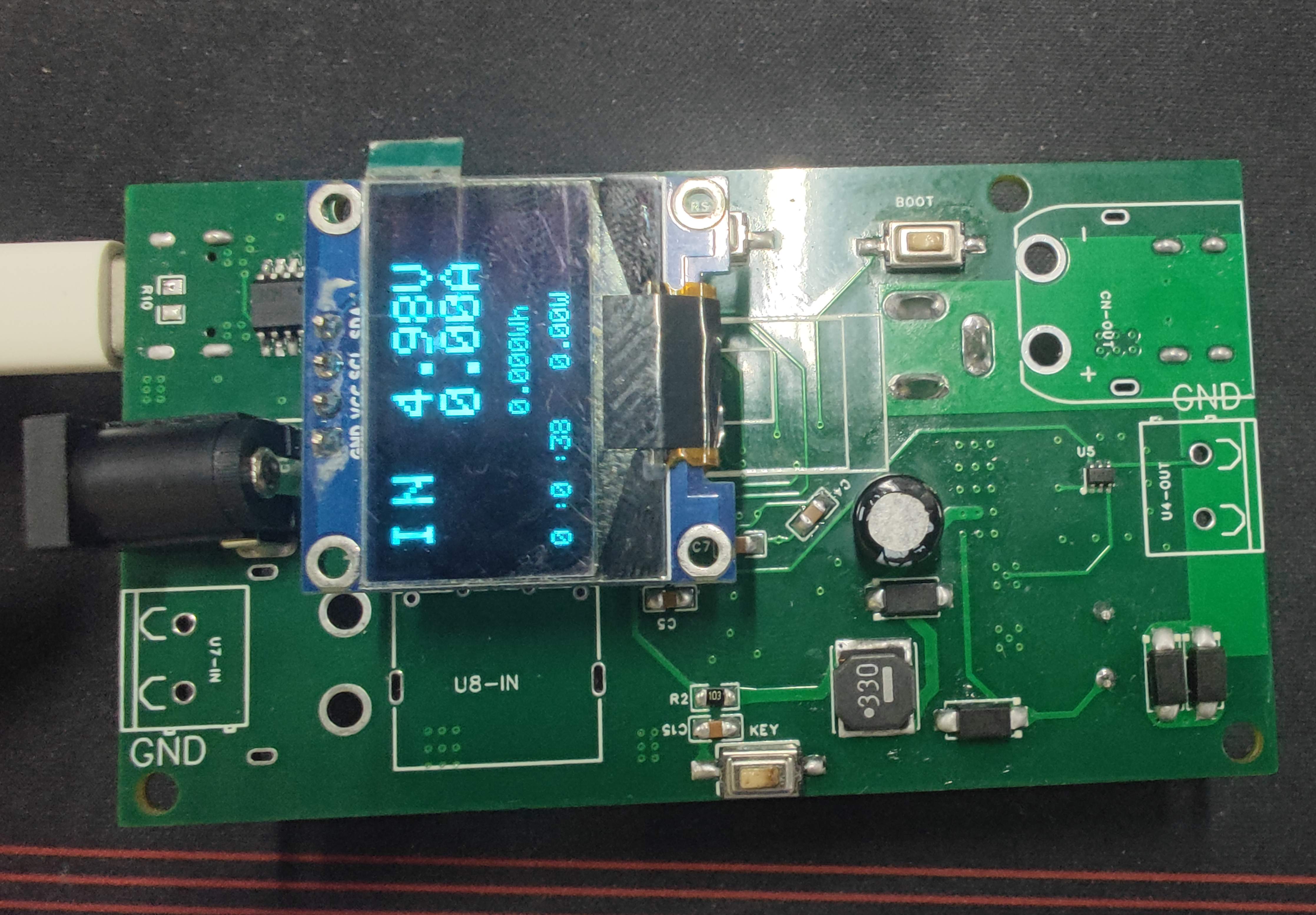

* 1. Introduction to project functions
The main function monitors the input and output current and voltage (0-30V, 7A fuse), and can be used to spoof voltage through typec. The pfc cable is used to control the buck-boost module I already have, which can be left blank in this project. The XT60 at the input end conflicts with the terminal block, but it is left for the convenience of expansion.

*4. The hardware part
uses INA199B1DCKR to detect the circuit current, the resistor divider to detect the voltage, and reads and displays it on the oled through n32g430adc. In addition, the CH224K chip is used to control the different voltage outputs of the charging head.
