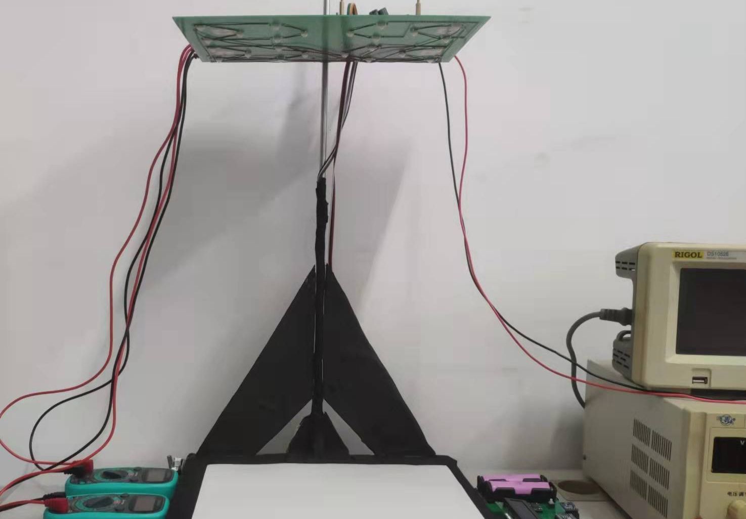

        The independently designed and developed LED desk lamp with stable and adjustable illumination is divided into dimming desk lamp and digital display illumination meter. A wooden board covered with black flannel tape is connected to a 60cm optical axis as the frame of the dimming desk lamp; two ArduinoNano microcontrollers with soft string communication and interaction coordinate the realization of various functions of the desk lamp; a BH1750 illumination sensor collects illumination information; four groups of LEDs are evenly dispersed The lamp beads are connected in a circuit of three in series and two in parallel (three series lamps are one group, and two groups of lamps are connected in parallel); one button enables the desk lamp to switch
freely ; an adjustable power supply with stable output is used to power the desk lamp.
The digital display illuminance meter uses an Arduino Nano microcontroller as the control center; an illuminance sensor as the illuminance information collection part; an LCD1602 liquid crystal display as the illuminance information display part; and a manually switchable buzzer as the illuminance information reminder part; use Two 18650 rechargeable batteries power the light meter

       In the lamp bead part, we use 24 lamp beads for lighting. We divide the lamp beads into four parts, each part has 6 lamp beads. Six lamp beads are connected in three series and then two sets of parallel circuits are connected in parallel to ensure uniform lighting. Below is our schematic.
Actual object as pictured
