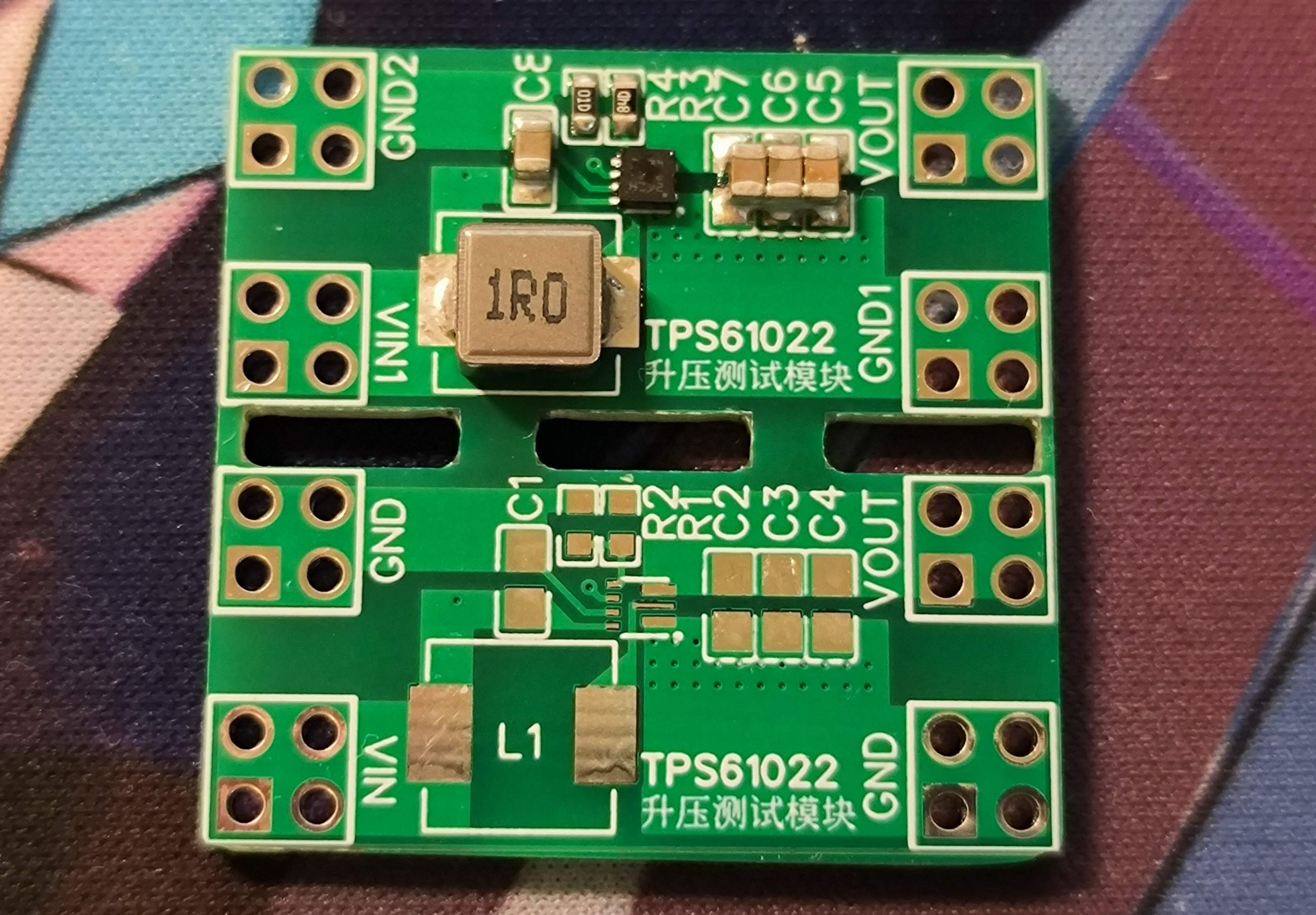

TPS61022 Boost Module
DC-DC boost chip TPS61022RWUR C915088Input
voltage range: 0.5V to 5.5V• Minimum input voltage at startup is 1.8V• Output voltage setting range: 2.2V to 5.5V• Two 12mΩ (LS)/18mΩ (HS) MOSFETs• 8A valley switch current limit• Efficiency is 94.7% when VIN = 3.6V, VOUT = 5V and IOUT = 3A
• Vfb = 0.6VGenerate
schematic using WEBENCH® POWER DESIGNERRefer
to the layout in the datasheetModule
size: 30mm x 13.56mmThe
inductor used here is C3002614 1uH ±20% 9ALiChuang has a 30-15 coupon (
actual test:
output 5V2A
output 5V3A There is a certain temperature rise. Pay attention to heat dissipation
. Under 5V3A, the output voltage can be appropriately increased by 0.1v.
According to the following formula, calculate the R1 R2 value.
When Vout = 5.1V, R1:R2 = 7.5:1. 750k 100k can be selected.
