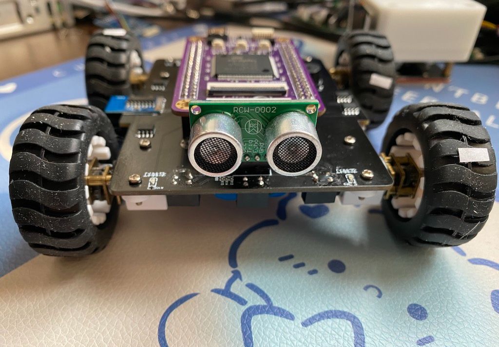

      This time, the main purpose is to learn some smart car control. Secondly, because it is the first time to make a smart car, and considering cost saving, the shape is relatively rigid, because the purpose of this design is to learn better!
     The highlight of this design should be the WeChat applet control. After all, WeChat, everyone has it. It is basically impossible for a smart phone not to install WeChat, right! Therefore, the versatility is very high, and there is no trouble of bringing a separate remote control. If you are interested, you can also scan the applet code to enter, but everyone’s device is not adapted, so there is no way to connect. If you want to use it, you can also burn my firmware and use the Bluetooth module I bought (or report the Bluetooth UUID to me and add it to the applet).

     3. Ultrasonic ranging module:
          The model is HC-SR04. This module is very easy to use and the measurement is relatively accurate, but I have had some small accidents here, because this module has been bought for a long time. It was relatively normal when it was debugged at the beginning, but then I don’t know why the distance measurement suddenly did not change. I don’t know how it broke. It just so happened that I saw some things at Lao Wang’s house, and I bought his ranging module RCW-0002. This module is strange. It seems to be the same as HC-SR04 when searching for information online, but the measured distance is almost half less, and it also jumps randomly. This is the reason for the inaccurate distance measurement in the video. It is estimated to be a defective product, but the whole project has reached the end of processing, and it will take a few days to buy one, so I will make do with the measurement first. At present, it is still relatively prepared when the distance is close. At least there is no big problem in automatic obstacle avoidance, don’t you think?
