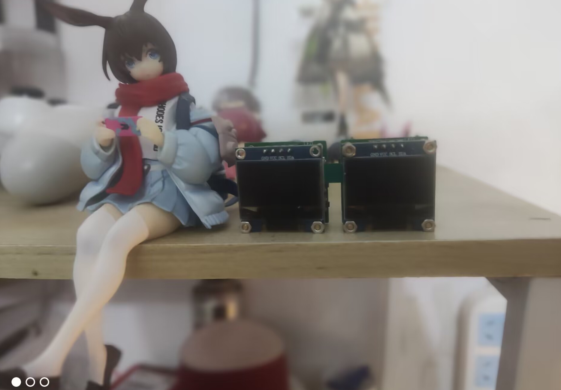

ESP82660.96 inch small TV
An esp8266 small TV (0.96 inch) that supports USB serial port
uses the esp8266 module:
it is recommended to use the esp12f module
serial port chip: CH340G
three button connected io:
D5 (IO14), D6 (IO12), D7 (IO13)
has been verified, Compatible with WiFi weather clock firmware, more interesting programs are being explored QAQ
