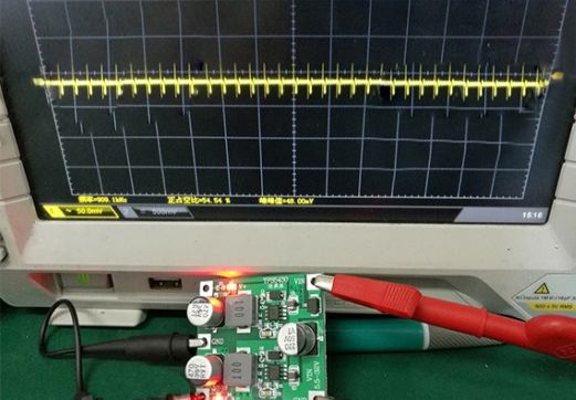

TPS5430 voltage stabilizing circuit-5V
TPS5430, wide voltage input, 5.5V-36V
TPS5430 has good characteristics, its main parameters are as follows: high current output 3A (peak 4A); wide voltage input range: 5.5-36V: high conversion rate wide voltage output range: fixed 500kHz conversion rate , has over-current protection and thermal cut-off functions, has a switch enable pin, and is only 17uA in the off state. Quiescent current internal soft start Compared with other DC switching power supply conversion chips of the same type, the high conversion rate of TPS5430D deserves more attention.
In this schematic diagram, the output is set to 5V, which can be combined
