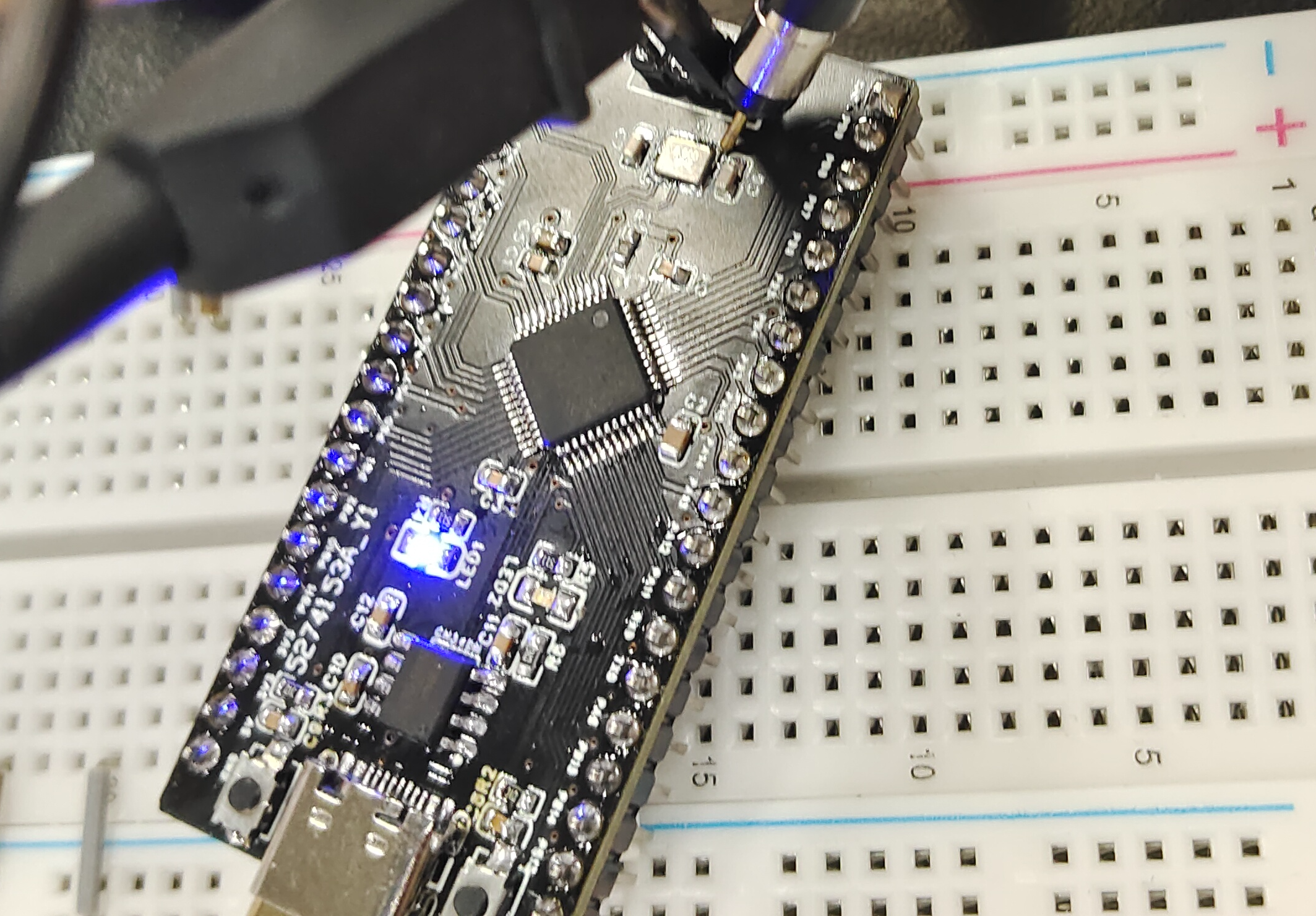

The domestic APM32F103C8T6 smallest development board is compatible with STM32 and uses the advanced TYPE-C interface. You can directly use TYPE-C for program burning and lead out all pins.
The program is fully compatible with stm32. When burning the program, you need to choose the corresponding FLASH
program burning method of APM32 and APM:
first find the APM32 pack download on the MDK5 Software Packs (keil.com) official website of MDK (the pack is placed in the project attachment). Then double-click to run, then open keil5, open the stm32 program that can be compiled normally (the simple lighting program is placed in the project attachment), then select the corresponding APM32 development board
and compile, but at this time the compilation will report an error, mainly because APM32 The device does not appear in the header file of stm32f10x.h.
You can see that if you recompile at this time, no error will be reported. Finally, replace the FlashDownload with the APM32 device and you can use a burner such as STLINK or JLINK to burn the program. If there is When an error is reported, check RESET AND RUN and the program can be burned.
Comparison with stm32 after final burning
