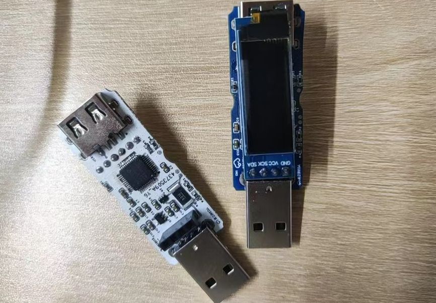

* 1. Introduction to project functions
  The USB ammeter reproduced based on the LiChuang Electric Race Training Camp and the National Technology Teaching Support
can detect the voltage and current within 5V2A, and display the real-time voltage, current and power through the OLED in real time.
1. Combined with the National Technology & teaching video, draw the PCB board, but cancel the crystal oscillator.
2. Design the circuit to detect the current, open the window of the current line and tin it (learn new knowledge through the feedback of Mr. Liu)

2. According to the selected schematic diagram, try to layout the components (the following points should be considered)
  2.1 The layout process can use automatic wiring to verify the rationality of the layout and the difficulty of implementation.
  2.2 The difficulty of routing after layout
  2.3 The difficulty of welding after layout and how to install with the USB public shell
3. PCB routing, considering the current peak value of 2A, it is necessary to set VCC, detect the line width of the current and the line width of the 3.3V power line

*4. Hardware part
The hardware part is roughly classified according to the schematic diagram
1. The main control circuit
VDD, VSS is connected to the capacitor to keep the voltage stable, because the voltage of the capacitor does not change suddenly.
2. Power step-down circuit
3. Reset circuit
4. Serial port debugging circuit
Use ST-LINK/V2 for debugging
5. Voltage sampling
6. Current sampling
7. BOOT selection
Note: It is recommended to use Jiali Chuang EDA. If you choose other EDA tools, please upload the schematic diagram in PDF format, the PCB drawing in PDF format, and the PCB file in Gerber format in the attachment. Here you can explain in detail the implementation principle and mechanism of your project, precautions, debugging methods, testing methods, etc. It is recommended to introduce your ideas to others in the form of pictures and texts.
*5. Software part
Through the software design in the teaching video of Li Chuang Training Camp, build the development environment of N32430 in Keil, import the Pack package, and learn by referring to the source code.
However, due to the chip welding failure, the chip tinning problem was not handled properly twice, which caused the 3.3V and GND tinning to cause a short circuit, and the power-on detection could not be performed, so the software part design could not be carried out
