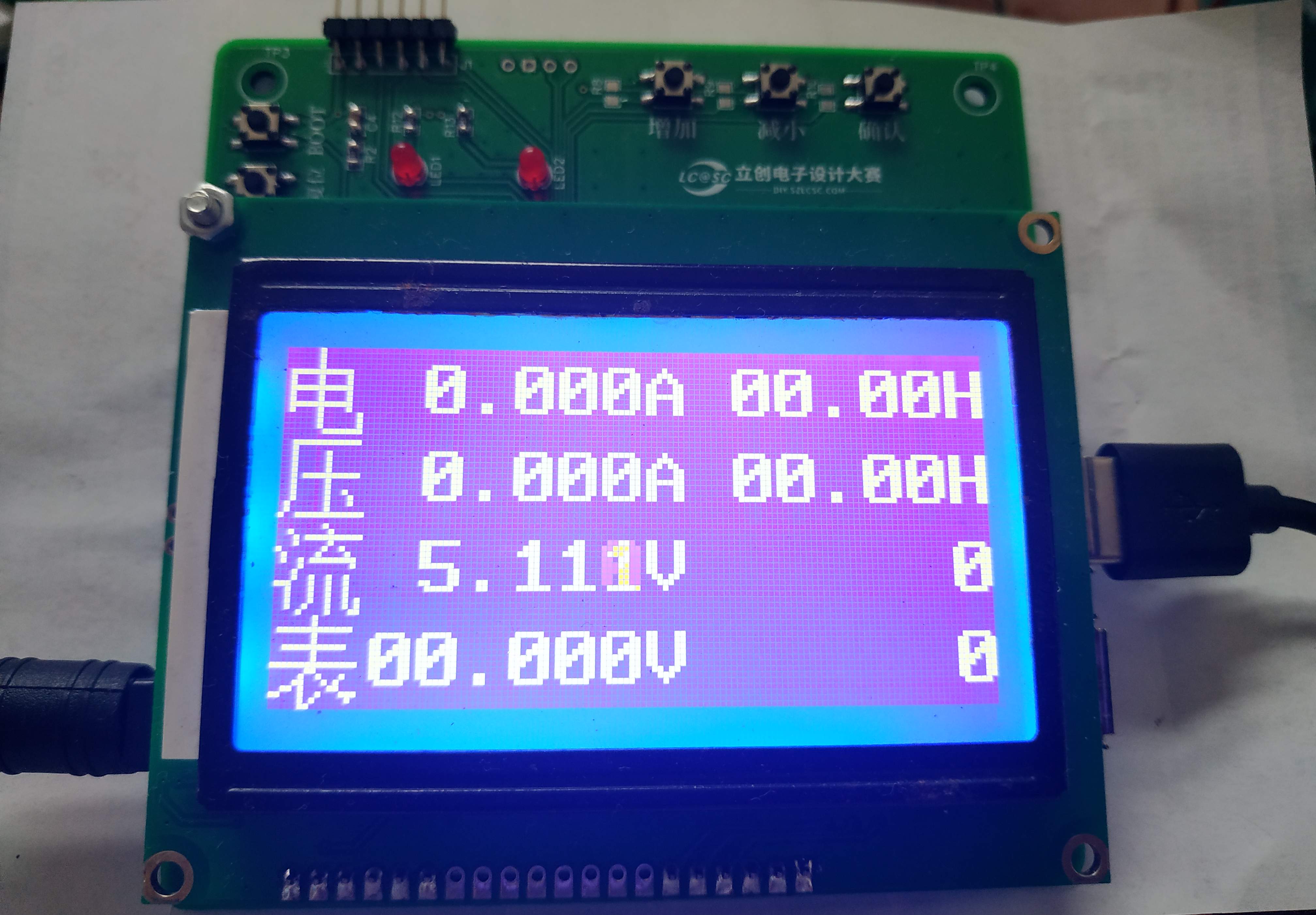

* 1. Project Function Introduction
    The USB ammeter made based on N32G430C8L7+INA199 can check the current when the USB is working. There are 2 LED lights for debugging and working instructions, and 3 buttons for setting parameters. Because the LCD12864 screen is used, the display font is large, with charging capacity and charging time display, and it can also be used as a voltage and current meter alone. As an electronics enthusiast, I am very concerned about the capacity of the rechargeable battery and want to learn domestic single-chip microcomputer programming through this activity.
    Through parameter correction, the AD correction coefficient is saved in the FLASH of the N32G430C8L7 chip, which is convenient for calling the AD correction coefficient after power-on, thereby realizing the software correction of the voltage and current meter values. The main control chip
of the main device
    adopts the 32-bit N32G430C8L7 chip. One way is to sample the current through the R02 sampling resistor, and the sampling signal is amplified through INA199B1DCKR, and sent to the AD port of the single-chip microcomputer for quantization processing. The other way is to sample the current through the R02 sampling resistor, and the sampling signal is amplified through LM358, and sent to the AD port of the single-chip microcomputer for quantization processing. Compare the two signal amplifier circuits, and display them on the LCD12864 LCD screen.
Hardware design
1. Power supply circuit
2. Current sampling circuit
3. Voltage sampling circuit
4. Start selection
5. Reset circuit
6. MCU burning port
7. LCD12864 display
8. 2 LED lights
9. 3 buttons
10. Two USB outputs
11. Main control chip
12. Extension 1---external crystal oscillator
12. Extension 2---buzzer
13. BOM
schematic diagram
PCB

*5. Software part
compilation software---Keil uVision5
    timer 6---10ms interrupt once, display---500ms refresh once, 4-way AD sampling, after recursive filtering algorithm, send to people for display. Function
realization
    The first time the power is on, through the confirmation key, first save the preset correction coefficient in FLASH, and then read the correction coefficient again. If the display is inaccurate, you can modify the correction coefficient through parameter correction to get the correct current and voltage values.
1. Normal display Voltage and current table USB1---current, capacity, time USB2---current, capacity, time USB----voltage External---voltage
2. Parameter correction USB1---current value fine-tuning correction USB2---current value fine-tuning correction USB----voltage value fine-tuning correction External---voltage value fine-tuning correction After the correction is completed, the correction coefficient is saved in FLASH. After the chip is powered on, the correction coefficient is read from FLASH first.
3. Backlight control Increase key-----turn off backlight Decrease key-----turn on backlight Confirm key-----turn on backlight
4. LED light LED1 light------temporarily unused LED2 light-----timer 0.5S flash
5. Ammeter USB1-------current, maximum range 3A USB2-------current, maximum range 3A
6. Voltmeter USB--------voltage, maximum range 3V External-------voltage, maximum range 30V
7. Capacity USB1-------capacity, maximum range 99.99ah USB2-------capacity, maximum range 99.99ah
8. Charging time USB1-------time, maximum range 9999 minutes USB2-------time, maximum range 9999 minutes
