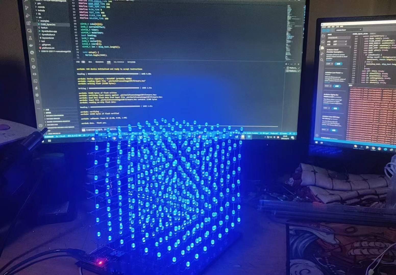

# LED_cube production process
Pay attention to pitfalls! ! !
There is a flying wire on the PCB board. I don’t know why it is not connected. I welcome you to repair and supplement it.
## Let’s enjoy the two finished pictures first
! [d16079e9daf8e0d298869ddee5c19d8.jpg]
![2d2ed4b9291244d9d70619e1ab41b31.jpg]

the 8*8*8 light array in the picture below? It means that you have to break off at least 512 lights in advance to prevent any breakage. You can break off 20 more for spare
because it is a sinking type. Light array, so PCB diode spacing, perforated plate spacing and subsequent diode modification must be operated according to the requirements in the diagram, otherwise big problems will occur during assembly.
Note: In this project, the anode of the diode should always be facing
down. Come on! ! ! I broke off these 540 lamps for about a week (while I was in class at school) (#^.^#)

### Assembling and welding LED lamp beads
Now the role of the perforated board comes
! [b111c0837cf8200c06636da030d4515.jpg] According to the picture above, assemble the perforated board and pin rows (six holes apart) Put) not more, not less.
The size here is still a bit small (after all, the price is cheap). The most economical solution is 4*4 (calculate the size by yourself).
Start assembling the first piece (the positive electrode is always facing down, and the negative electrode is to the right. )
![97158cb4398325ec629af62f7b5ef86.jpg]Here I am putting together two pieces (one column is not enough).
Let me show some process pictures. A total of 8 pieces are needed. The welding operation of each piece is the same.
This project can really practice welding skills
! [63d1123efc8d01fd1f70831f69834d0.jpg]
