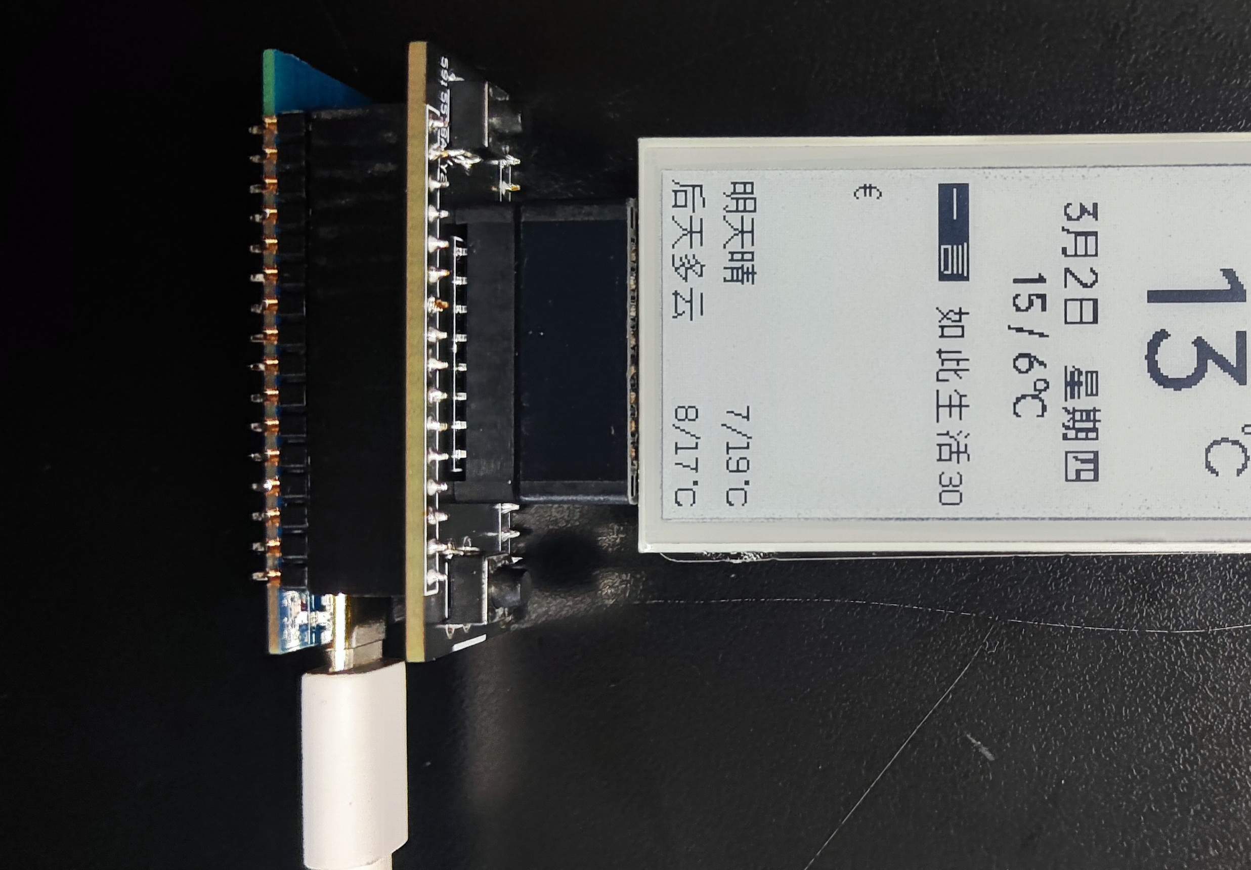

ESP32C3 ink screen display (reproduction)
1. Physical display
2. Burning program
   First download the "download_tool_3.9.2" package provided in the attachment. After downloading and opening, you will see a burning program. Click to open it.
(The following window will pop up. Set it according to the following display. Note: The following settings are only for the classic version of esp32c)
Then download the "Program.bin" provided in the attachment and load it into the first green strip in the picture below. (Other settings are also as shown below. Note that com varies from person to person. You can click on your computer control panel to view the serial port used by your chip)
Click ERASE --> START in sequence to complete the burning
3. Obtaining Xinzhi Weather
  Search "Xinzhi Weather" in the browser to complete the user registration and select the free version to obtain it. (As shown below)
Click to get the free version (there will be the following interface, remember the private key inside, we will use it when configuring the network later)
4. Deslnk WiFi configuration
  After completing the welding of components, press keep to enter the network configuration. After
connecting to the network configuration wifi on the computer ,
you will enter the network configuration interface (if there is no automatic jump, you need to manually search 192.168.1.1 in the browser to enter the network configuration)
Click the network configuration (the first password is your own WiFi password, and the second key is the private key I mentioned above)
After configuration, the following picture will appear.
The left button is to change the mode (a total of four types), and the right button is to refresh
