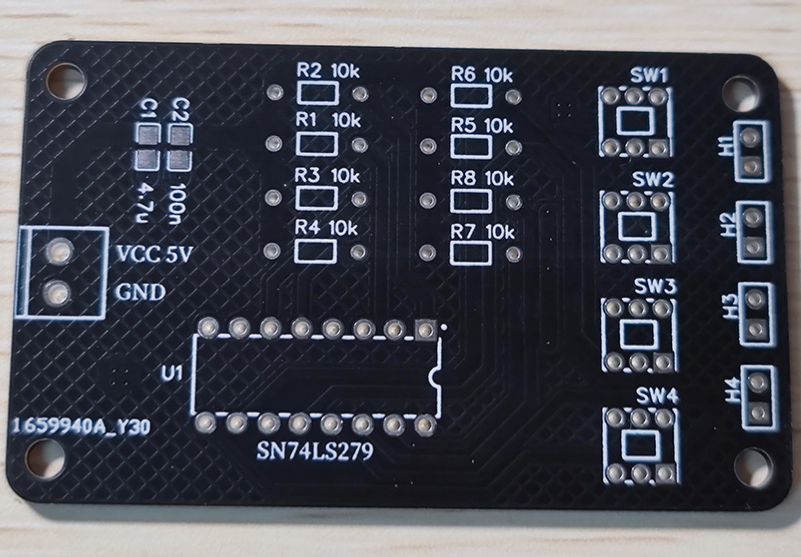

SR latch button anti-shake board
### Update
2022.11.23 v1.0 alpha has been board verified.
### Project display
#### Appearance
![1669213526137.jpg]
![1669213526123.jpg]
#### Waveform measurement
![Uh, the resistor on hand is too big to fit in]
![1669212642420.jpg]
![ 1669212642437.jpg]
If you want oscilloscope waveform data and screenshots, you can get them in the engineering attachments.
### Project Description
H1 and H2 default to **high level** output when the buttons are not pressed; H3 and H4 default to **low level** output when the buttons are not pressed.
The output high level is 5V.
### Notes
- When purchasing, please note that the resistor is a small resistor with a power of 1/8W (uh, I didn't notice it on the drawing board).
- Pay attention to the direction of the normally closed contacts of the lockless switch when welding.
