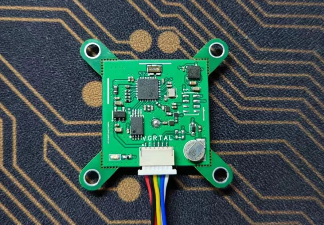

M8030_GPS module 30 holes
The first version of the proofing test was successful on March 26, 2023. About 12 satellites were searched in the open space outdoors. However, the signal is weak
and the impedance needs to be optimized. The current version is not recommended for direct use! ! !
The GPS module based on ublox M8030-KT chip integrates 5883 compass and 5611 barometer. It can be used for pixhawk flight control.
The hole spacing is 30.5. It can be directly installed on the upper layer of the flight control of the traversing aircraft. It can also be used without the fixing hole. The overall size is 25*25 with the same antenna. Dimensions
, pin definitions,
application layouts are officially recommended A.
Please strictly abide by the official documents when selecting type A.4 crystal oscillator!
