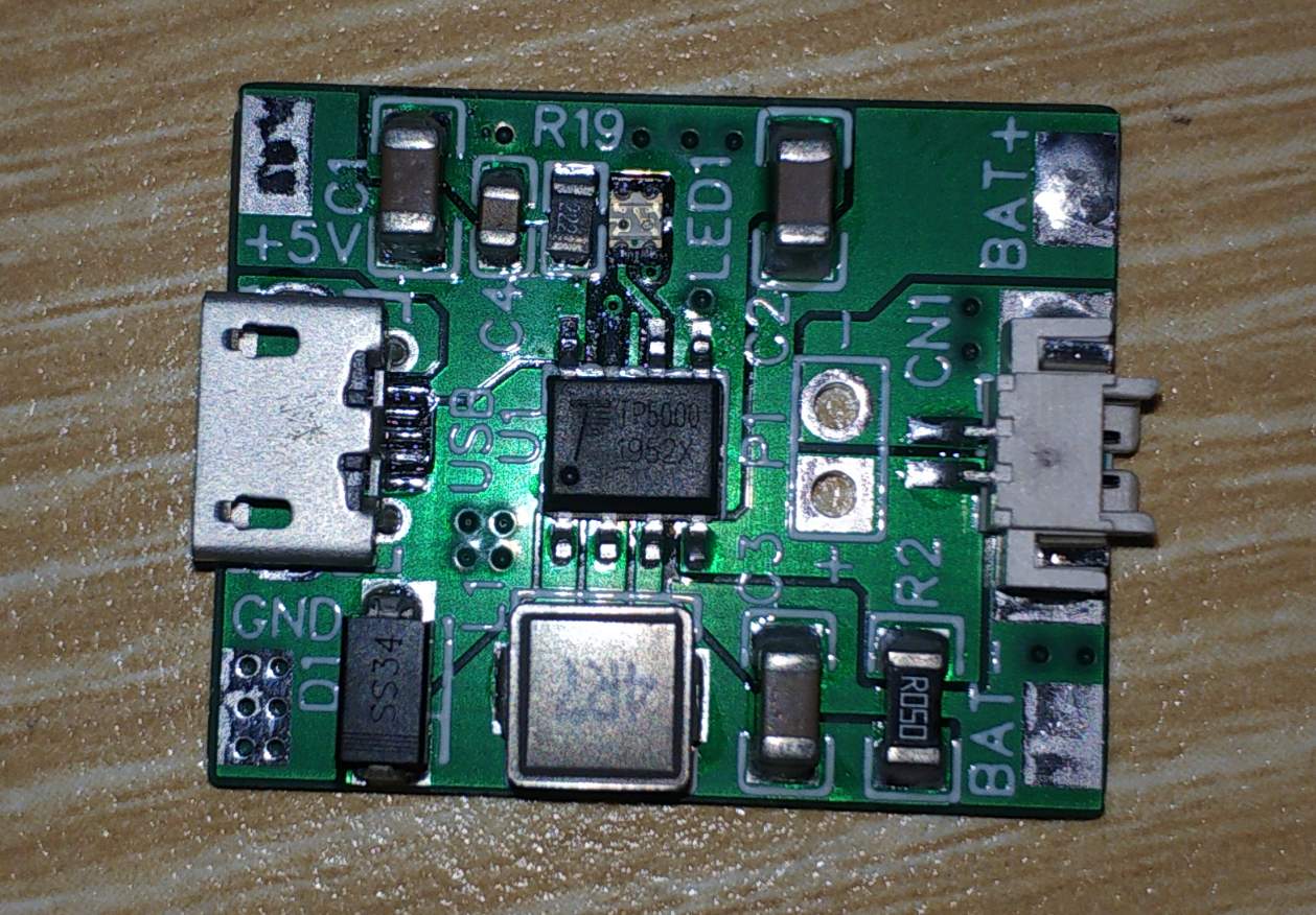

TP5000X charging board
1. Easy to solder by hand using ESOP8 package.
2. The use of small package two-color LEDs has a compact structure. It can either weld one two-color 0603 LED or two 0603 package LEDs separately.
3. Sufficient via holes should be drilled at the bottom and around the chip for heat dissipation.
4. The interface is clearly marked, and the input can use welding input and Micro-USB.
5. The output can use 2.54, MX1.25 and welding.
