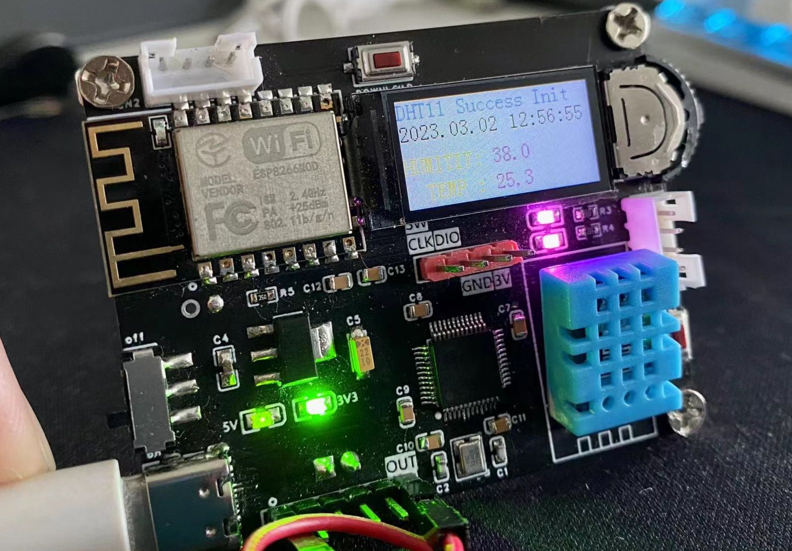

controls the DHT11 and IPS screens through STM32F103C6T6. The ESP12F connects to the network and reports data to the Gizwits cloud platform. You can use the mobile phone debugging assistant to see
# PCB design instructions
##### The board is reserved for compatible CD42 charge and discharge modules and batteries. Interface, if not needed, you can short-circuit the leftmost and rightmost pins and use the TYPE-C interface to directly supply power
! [image.png]
The serial port RX TX next to the ESP corresponds to the RX TX of the ESP8266,
but the one next to the STM32 RX TX corresponds to the TX RX of STM32 (the silk screen is reversed)
