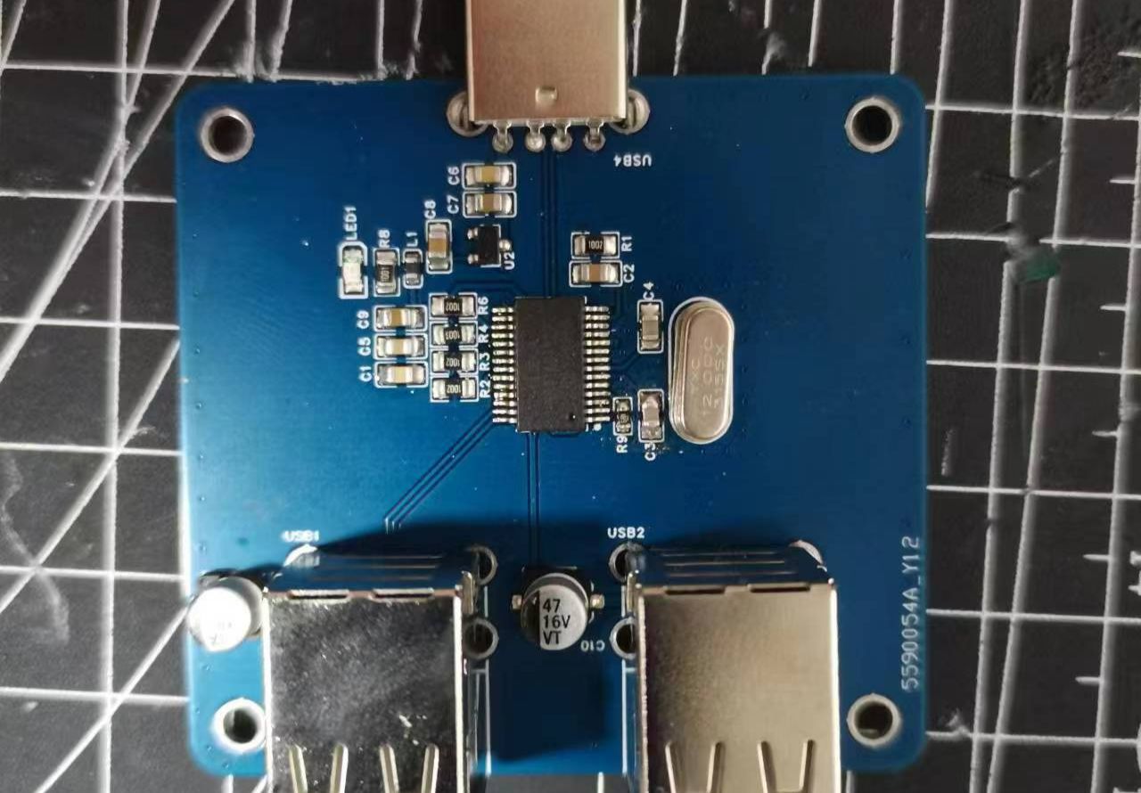

Expander designed based on GL850G four-way USB2.0.
The input uses a USB male connector (the male connector seems inconvenient in actual use, and can be changed to a female connector later), and the output uses two two-way USB2.0 female connectors stacked.
Most of the entire board is packaged in 0805 (two are packaged in 0603), which is convenient for personal welding.
The board has four M3 slots, so you can design and install the casing yourself.
Physical picture:
