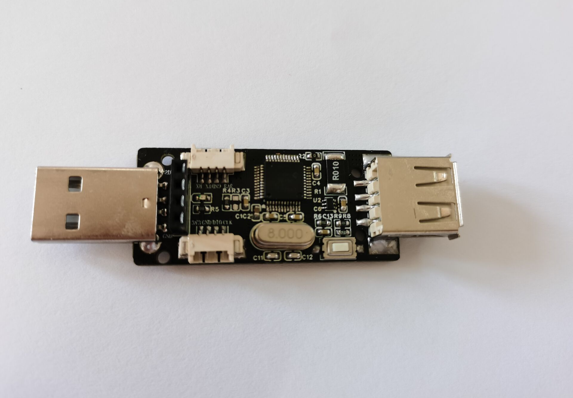

### 13. Proofing physical picture
#### The above is the process of all hardware circuit design, proofing, and the physical picture is shown in the figure below.
![15. Proofing physical picture.jpg]

## Problems encountered
### Problem 1
Problem 1 is: After soldering, the OLED does not light up!
Solution: The official IIC drives the OLED with **PA4, PA5**, and the IIC drive OLED pins of the power meter I designed are: **PB13, PB14**, so the code needs to be changed. What I show here is the changed code!
The first change: in the MonoScreen.c file
````c
#define I2Cx I2C1
#define I2Cx_SCL_PIN GPIO_PIN_13
#define I2Cx_SDA_PIN GPIO_PIN_14
#define GPIOx GPIOB
Change the second place: In the MonoScreen.c file, the clock start function and the pin setting function need to be changed to GPIOB.
### Problem 2
Problem 2: After changing the pin definition in the code, the OLED still does not light up.
Solution: The official code uses the internal high-speed clock of the **chip** as the system clock of the program, and we welded an external high-speed clock, there will be a bug, there are two solutions: 1. Remove the external high-speed clock; 2. The program code.
I won’t talk too much about the first method, just remove the crystal oscillator and the debt capacitor! Then the OLED will light up.
The second method is to use the external high-speed clock as the system clock, which is also the method I finally adopted after repeated tests.
I also used method 1, and it worked fine. However, in order to make the development board look good, I still soldered the external high-speed crystal oscillator. As a result, the screen did not light up, so I started to modify the code.
It mainly adds one line of code. The specific code is as follows:
````c
void SetSysClockToHSE(void)
RCC_Reset();
RCC_HSE_Config(RCC_HSE_ENABLE);
HSEStartUpStatus = RCC_HSE_Stable_Wait();
if (HSEStartUpStatus == SUCCESS)
FLASH_Prefetch_Buffer_Enable();
if (HSE_Value <= 18000000)
FLASH_Latency_Set(FLASH_LATENCY_0);
else
FLASH_Latency_Set(FLASH_LATENCY_1);
RCC_Hclk_Config(RCC_SYSCLK_DIV1);
RCC_Pclk2_Config(RCC_HCLK_DIV1);
RCC_Pclk1_Config(RCC_HCLK_DIV1);
RCC_Sysclk_Config(RCC_SYSCLK_SRC_HSE);
while (RCC_Sysclk_Source_Get() != RCC_CFG_SCLKSTS_HSE)
else
while (1)
Then put this function in main.c and call it, and then the screen will light up!
### Problem 3
Problem: After trying all the above attempts, the OLED still does not light up.
Solution: The board is poorly soldered. Add more solder and tap each pin again. I have tried this and there is no problem later.
### Problem 4
Problem: The value displayed by OLED is not standard. When given 5V, it displays 4.something volts.
Solution: The main problem here is that some people’s hardware is different from the official value, resulting in inaccurate display. The solution is to change the coefficient factor of the program. I have explained in detail how to calculate it before, so I will not repeat it here.
