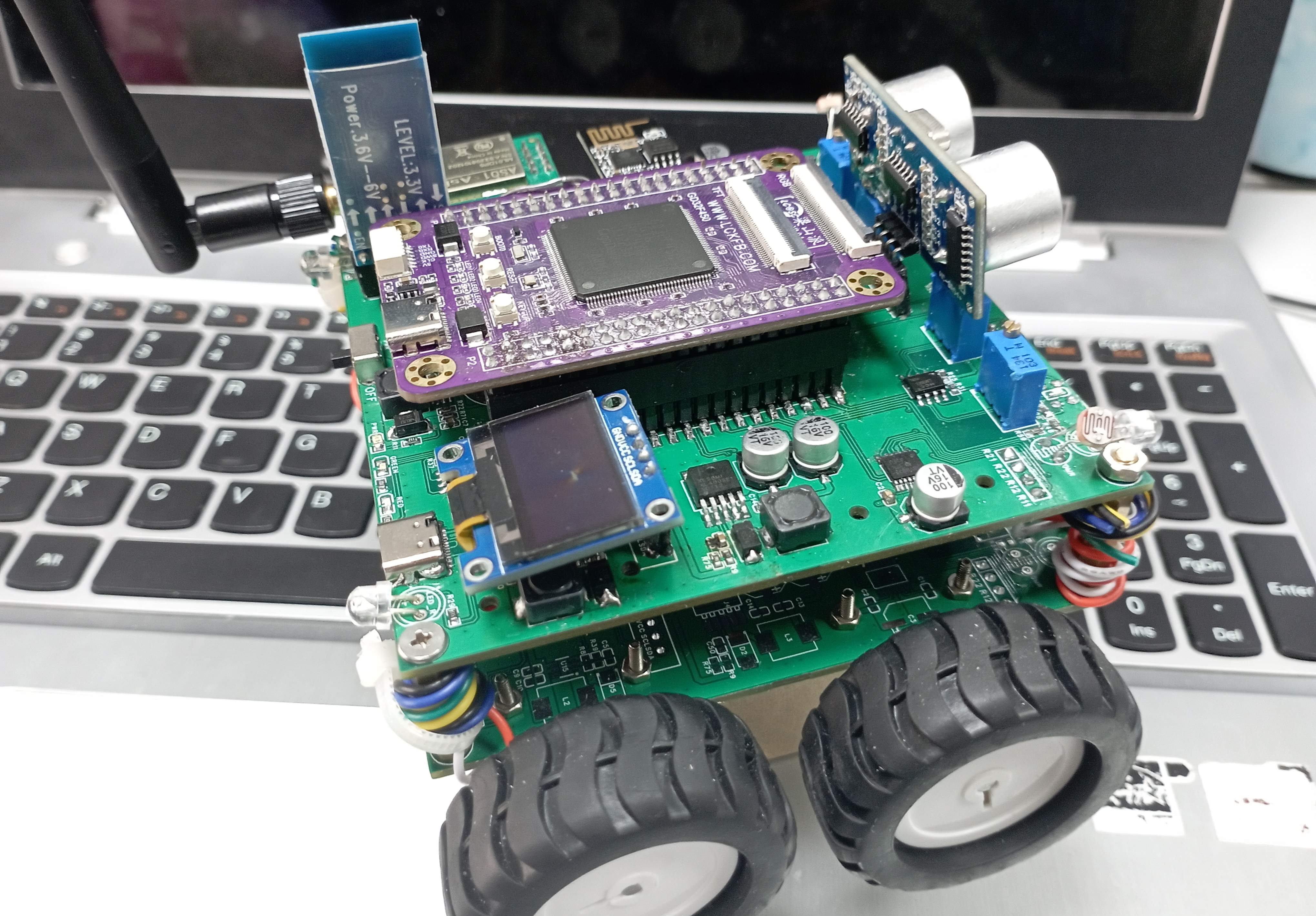

# Project Introduction
##### **This project is a winter vacation training camp project for the LiChuang development board. After learning it, I have mastered the following:**
>* I have a certain understanding of common motor drivers and drew the circuit myself to realize the function;
>* I mastered the principle of tracking circuit and realized the tracking function of the car;
>* I mastered the distance measurement principle of the SR04 ultrasonic module and completed the distance measurement function to achieve obstacle avoidance;
>* The power supply part of the entire car uses 3 18650 batteries in parallel and realizes the charging function;
>* I use the cheap and commonly used 0.96IIC interface OLED screen for display, recognize a monochrome GUI library, and successfully transplant it to display a better-looking interface;
>* I use the Bluetooth module HC05 for wireless control to realize the mobile phone APP to control the car through Bluetooth;
>* I use the WIFI module ESP8266 for LAN control to realize the mobile phone APP to control the car through WIFI;
>* I use the 2.4G module NRF24L01 for joystick control and design a remote control stick. The joystick controls the car through NRF;
>* Use 3 photoresistors, placed in 3 directions, to achieve the light-chasing mode (that is, turn on the side that is brighter)
. A voice broadcast function is also added. I saw it on the open source platform and really wanted to implement this function. I tried to design it according to the data sheet, and it passed the test in one try, which is great. But the sound is too stiff and the cost is high.
