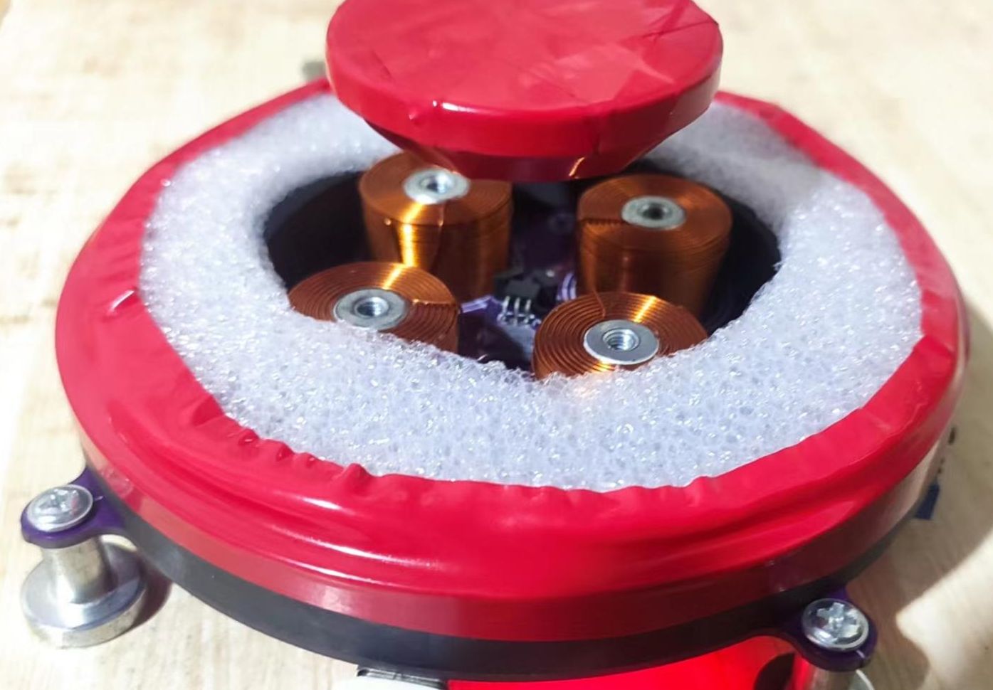

This project uses the STM32f103c8t6 microcontroller as the controller and has the following features:
1. Use the Type-C (USB-C) power supply interface and use the CH224KPD deception chip to deceive the 12V supply voltage.
2. Use the 7805 linear voltage regulator to provide 5V voltage to the Hall. Sensor, LM324 power supply
3. Use MIC5219 linear regulator to provide 3.3V voltage to power STM32
4. Use LM324 chip to amplify the analog signal to match the STM32 analog pin sampling (ADC), and use the DMA module for data transfer
5. Use the one-dimensional Kalman filter algorithm to filter the collected analog values ​​(to be verified)
6. Use the PID controller for control
7. Use the Bluetooth serial port to cooperate with the host computer to adjust the parameters of the PID controller and display the relevant parameters (to be verified ) Implementation)
8. Use IR2104 and PMLL4148L to form an H-bridge actuator
