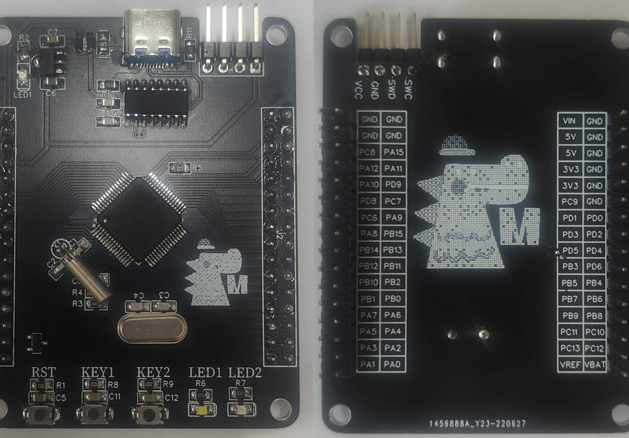

Core board picture:
       This project is the STM32G070RBT6 core board, which can be used for solution verification, etc. The chip uses the STM32G0 series, which is really cheap (compared to the STM32F series)!
       This core board includes external high-speed crystal oscillator (8MHz) and low-speed crystal oscillator (32.762kHz), power conversion circuit, power indicator light, Type-C interface (using CH340C chip), reset button, two ordinary buttons and two LEDs, download and use ST-Link (interface and lead-out) and all IO ports have basically been lead out (except serial port 1, two buttons and LED IO ports).
       STM32G0 series chips can be configured directly with STM32CuBeMX and directly generate Keil files, which is very convenient.
Core board verification:
  This verification is developed using rt-thread Studio software. The CH2 channel of TIM15 is used to control LED1 (breathing light). I2C communication is used to read the temperature and humidity information of SHT3X. I2C communication controls OLED. The core board verification demonstration video is as follows:
