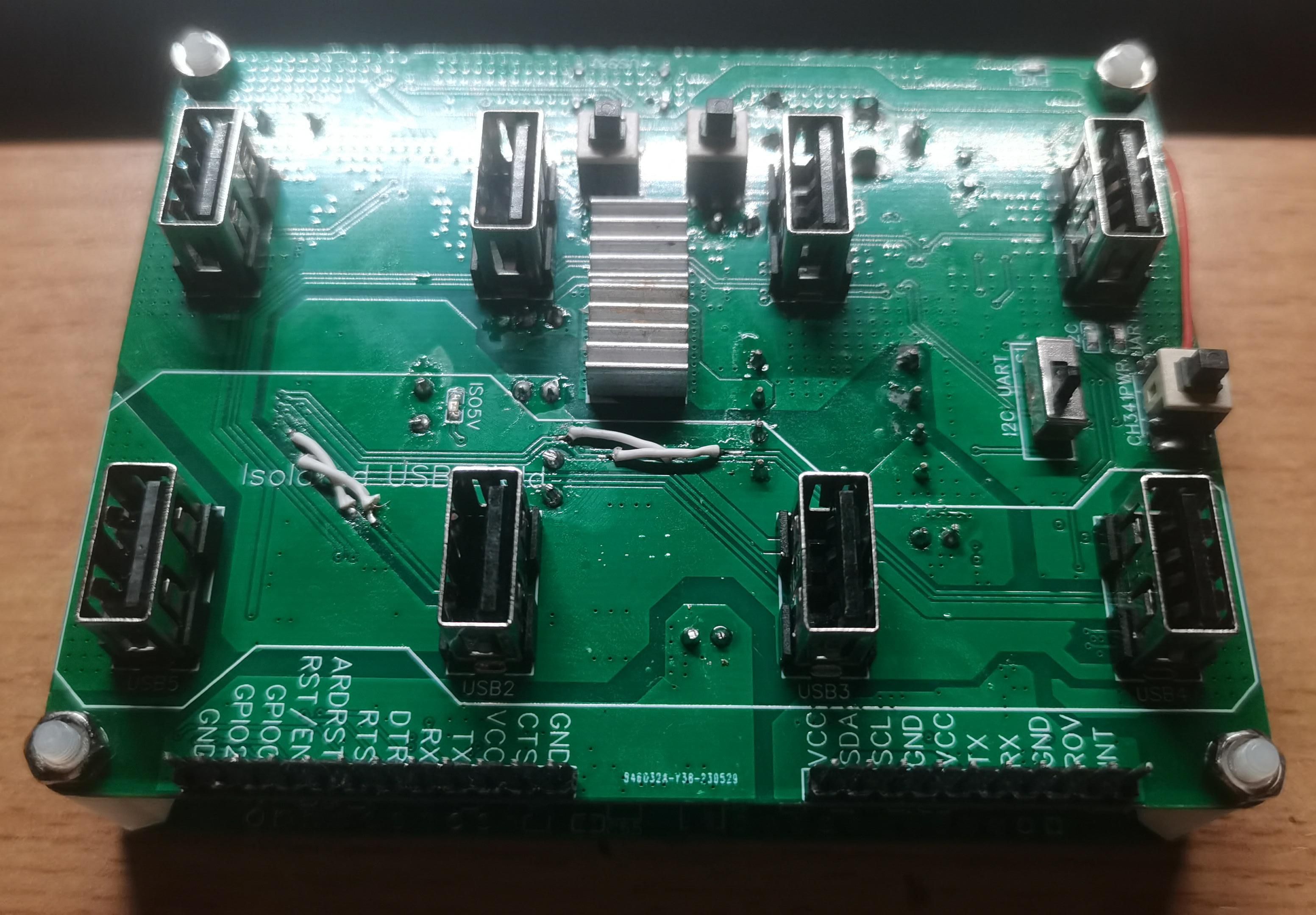

(The PCB and physical pictures of the released version are slightly different from those shown here. This is because the physical pictures are all made and debugged based on the semi-finished version, with many bugs. The released version has corrected these bugs)
The reason for doing this is that when debugging the microcontroller, the computer USB needs to hang a string of devices: serial port, STLINK/USBASP/USB-BLASTER, logic analyzer, etc. These must be connected to a HUB and then connected to the computer, otherwise the interface will not be enough.
I often debug some power supply works, many of which have high voltages that can damage fragile digital circuits. So one day, when I unplugged the DuPont line on the power evaluation board, a burnt smell came from the HUB, scrapping all the debuggers on it, and the mouse receiver and the computer's native USB were also implicated and burned.
So this Swiss Army knife-style design was produced, which may be convenient for some embedded hardware dogs or provide reference
parameters for those who design similar products:
        L*W*H: 98*75*30mm
        DC port input voltage: 4.5~15.5V
        Type-C port power supply voltage: 4.5~5.5V (DIRUPWR connected)
                                         4.5~15.5V (DIRUPWR disconnected)
        Type-C port PD application voltage: 15V
        Input interface: USB type-C USB2.0 480MBps
        Output interface: USB-A female port USB2.0 480MBps non-isolated *4
                          USB-A female port USB2.0 12MBps isolated *4
                          UART 2M BRR isolated *1
                          UART 2M BRR isolated *1 or I2C >400K isolated *1
        Maximum output current: 0.5A
Usage:
The HUB has 3 power sources: USB-C port direct supply, USB-C port PD high voltage, DC port external high voltage (external negative and internal positive)
In the former mode, please press the "DIRUPWR" button to ensure that each circuit that relies on 5V voltage to work gets enough voltage. In the latter two modes, be sure to disconnect this switch to prevent high voltage from damaging these circuits.
After the 5V circuit is powered on, the red "PWR" LED lights up.
The power supply of the isolation interface part can be controlled by the "ISOPWR" switch.
After the isolation part generates enough voltage, the yellow "ISO5V" LED lights up.
The pin definition of the debugging interface is provided on the PCB board. If the isolated power supply is disconnected, these interfaces will not work.
The power supply of the CH340 host side cannot be disconnected
. CH341 has two mutually exclusive functions of I2C/UART, which are determined by the state of the toggle switch when powered on. The "CH341PWR" switch provides a way to switch the CH341T function without disconnecting the main power supply. It can also be disconnected when not in use to reduce power consumption.
The green "UART" LED lights up in UART mode and the blue "I2C" LED lights up in I2C mode.

Welding and debugging:
Use LiChuang EDA to design, and free proofing is also available for 4-layer board designs. The board thickness can be selected from 1 to 1.6mm. Thicker boards have higher mechanical strength.
Welding must be distributed. After welding and debugging one part, proceed to the next part to prevent possible damage from spreading and facilitate DEBUG.
First, plug in 8 USB ports:
Then use solder paste to solder the patch parts of the primary power supply:
Test the input decoy and 5V step-down circuit; then solder the patch part of the isolated power supply:
Then start winding the isolated power supply transformer: Based on EE16 4+4 horizontal bobbin (parameters are provided in the schematic diagram notes)
Wind 1/2 primary winding according to the pin position and direction shown in the figure. The total length is 120cm. 0.35 enameled wire is wound in parallel for 9 turns: (the other half of the bobbin was accidentally broken)
The remaining wire ends are used as the remaining half of the primary winding, and 9mm high-temperature tape is wound around 3 turns;
then wind the secondary main winding (5V winding) as shown in the figure. 64cm triple insulated wire with a diameter of 0.2mm is wound in parallel for 6 turns, and after winding a circle of high-temperature tape, it is folded back
and wound 2 more circles of high-temperature tape
. Then wind the other two secondary windings as shown in the figure:
After 3 turns of high-temperature tape, wind the remaining wire ends of the primary winding back from the other end of the transformer and weld them to the frame, wrap the last insulating tape
and install the magnetic core. Use methods such as padding air gap/grinding air gap to control the primary open-circuit inductance to 7uH. At this time, the height of the padding air gap is 0.9mm.
Solder the primary HUB circuit, install the transformer and other isolated power supply direct plug-in
test these two circuits.
Please weld and debug the remaining isolated HUB, CH340, and CH341 by yourself step by step
This design does not have any programmable devices and does not require programming, but requires drivers for CH340 and CH341.
