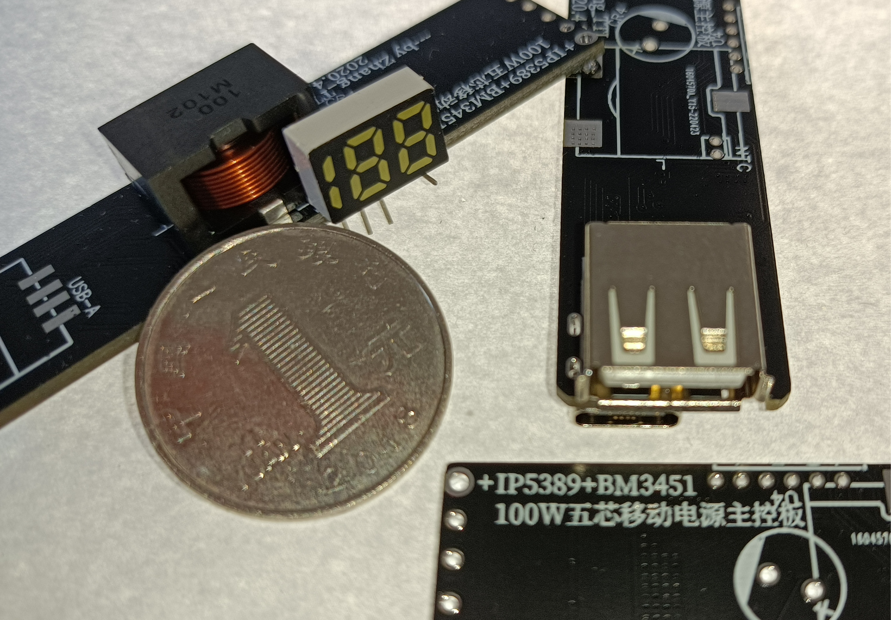

Ultra-small 100W bidirectional fast charging mobile power solution (verified)
1×USB-C 100W(MAX)
1×USB-A 36W(MAX)
The bidirectional PD100W mobile power solution with onboard battery capacity balance designed based on Ingenic IP5389-BZ chip and BYD BM3451
integrates QC2.0/QC3.0/SCP/VOOC output fast charging protocol, FCP/AFC/SFCP input and output fast charging protocol, MTK PE+1.1&2.0 output fast charging protocol, USB C/PD2.0/PD3.0 input and output protocol, USB C PD3.0 PPS output protocol, compatible with BC1.2/Apple/Samsung mobile phones.By
detecting the voltage, charge and discharge current, and ambient temperature of each battery, it realizes battery overcharge, over-discharge, discharge over-current, short circuit, charge over-current, temperature protection and other protection functions, and adjusts the overcharge, over-discharge, and over-current protection delay through external capacitors; it provides battery capacity balancing function to eliminate the capacity difference of each battery in the battery pack and extend the life of the battery pack.
All small patch components are arranged on the same side to facilitate welding with (PTC) heating plates, reducing the difficulty of welding!
The heating elements are arranged on the same side, which is convenient for close contact with the shell to dissipate heat.
Reducing the difficulty of welding, the volume is still extremely compressed, compressed to 11.30848cm2! ! !
Supports 5-series battery packs
and also supports lithium iron phosphate batteries (need to replace resistors to set the battery type).
The input and output power can reach up to 100 watts.
Note! ! !
When the board has high power input and output, the current at the battery end is very large, please pay attention to the selection of the battery.
The board comes with lithium battery protection and balancing circuits, and there is no need to use a protection board with balancing function at the battery end! !
