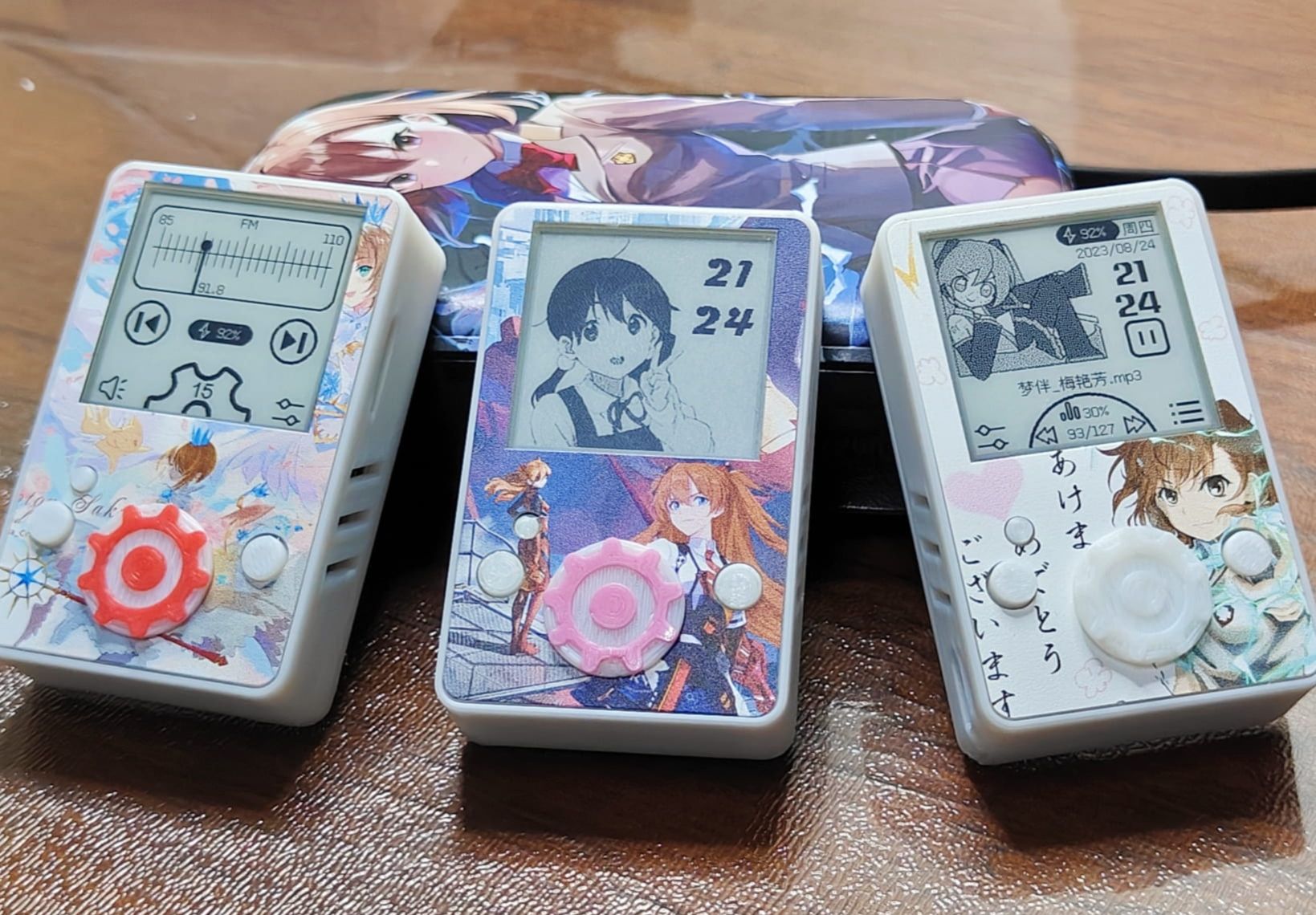

ESP32 Mini Ink Screen MP3 Radio Multifunction
Project Description
All functions of the 8266 version have been transplanted, and audio, power amplifier, and radio chips have been added.
It can be held in one hand, portable and hidden.

descriptionHardware
description1.54
Ink screen/ESP32-WROOM-32D 4MB
supports up to 32G SD card, using Maozi's SdFat library
Mouse encoder and mouse button, super long life, scroll wheel design
3.5mm headphone jack, can be used alone as a headphone and as a radio antenna, can also use the USB charging port as an antenna
Audio playback uses ES8311+NS4150, limited by the size of the board, only provides mono
radio Use RDA5807M module
Use ultra-thin side-generating sound cavity speaker 3520, 8Ω
clock chip RX8010, temperature and humidity chip SHT30
The clock uses button power supply & lithium battery dual power supply design
Add USB & lithium battery switching circuit, audio is another set of power supply If the battery is not connected, the charging chip must be soldered to supply
power Battery limit size 34x50x 3mm, which is also the size used now. 303450
