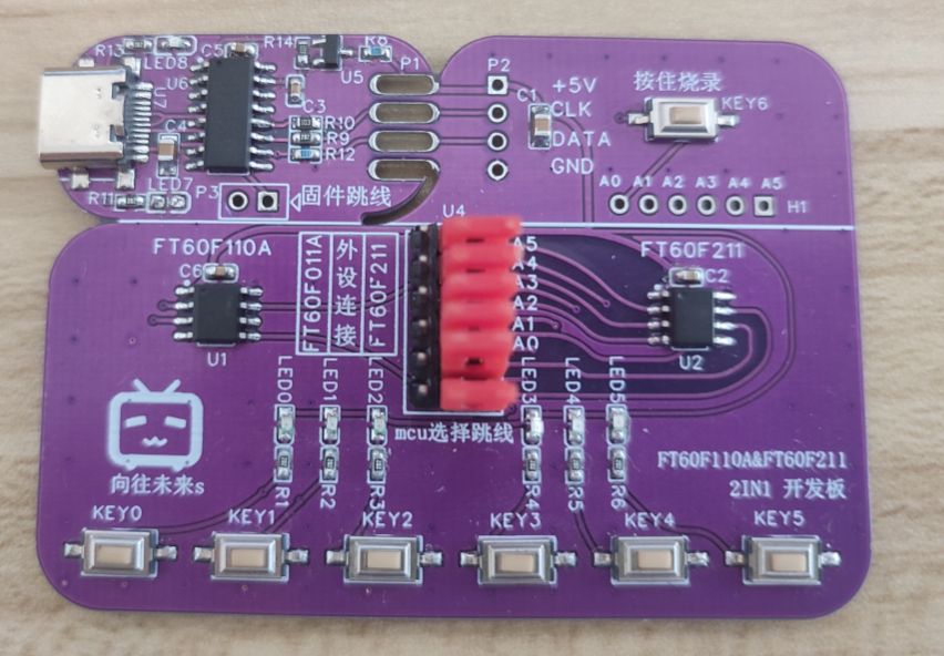

FMD F011A & F211 development board with programmer
MCU development board
MCU: FT60F011A and FT60F211
Onboard programmer: programmer chip ch552g
2-cent MCU, 8pin, 6 GPIOs can be operated, built-in 2 timers,
can be used to make toys and some simple commodities
Burning principle: Use ch552g to simulate the process of the burner (collected with an oscilloscope)
The downloader made by Fantong
adds a burning button to solve the problem of PA0 being occupied by the programmer
Jumper selection of the MCU to be used,
how to use, for the first time use, you need to download the program for CH552g
Download the burning software, unzip and install WCHISPTool,
1. After opening, select the 8-bit CH55X series, and select the chip model CH552,
2. Short the firmware jumper and power on,
3. Click the software search, and the device will be found automatically
4. User program file, select the hex in the folder File, click download to complete the burning,
the microcontroller downloads the program, and the subsequent downloads only need to operate here.
After the project is successfully compiled, open Fantong, select the model,
select the compiled file, check Restart, and click Download.
