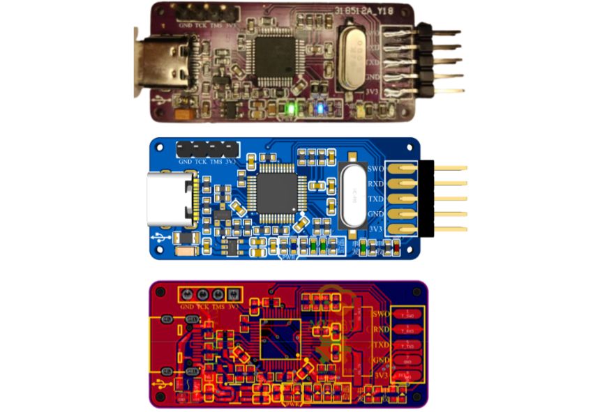

## 1. Features
are based on [Improved C-port version] for device modification and re-layout
## 2. Firmware burning
uses JLink for burning
## 3. EDA tool
uses Lichuang EDA Professional Edition for drawing
## 4. LDO modification
Since I have an LDO [LP2992IM5-3.3/NOPB] on hand, I replaced the original RT9013-33GB with LP2992IM5-3.3/NOPB.
The two LDO packages are the same. RT9013 is cheaper, so just choose RT9013
! [image.png] So when using RT9013-3.3, C5 in the picture below can be soldered empty
! [image.png]
## 5. Crystal oscillator Modify
the original crystal oscillator [material number] C111120 and replace it with the existing crystal oscillator on hand [material number] 】C252310, the existing crystal oscillator on hand is too large, so the layout has been greatly changed
! [image.png]
## 6. Layout and routing.
The original routing is basically 5mil or 6mil. This project will widen the routing to 10mil
* Layout
![image.png] **Original trace**
![image.png]
* **Wide trace**
![image.png]
