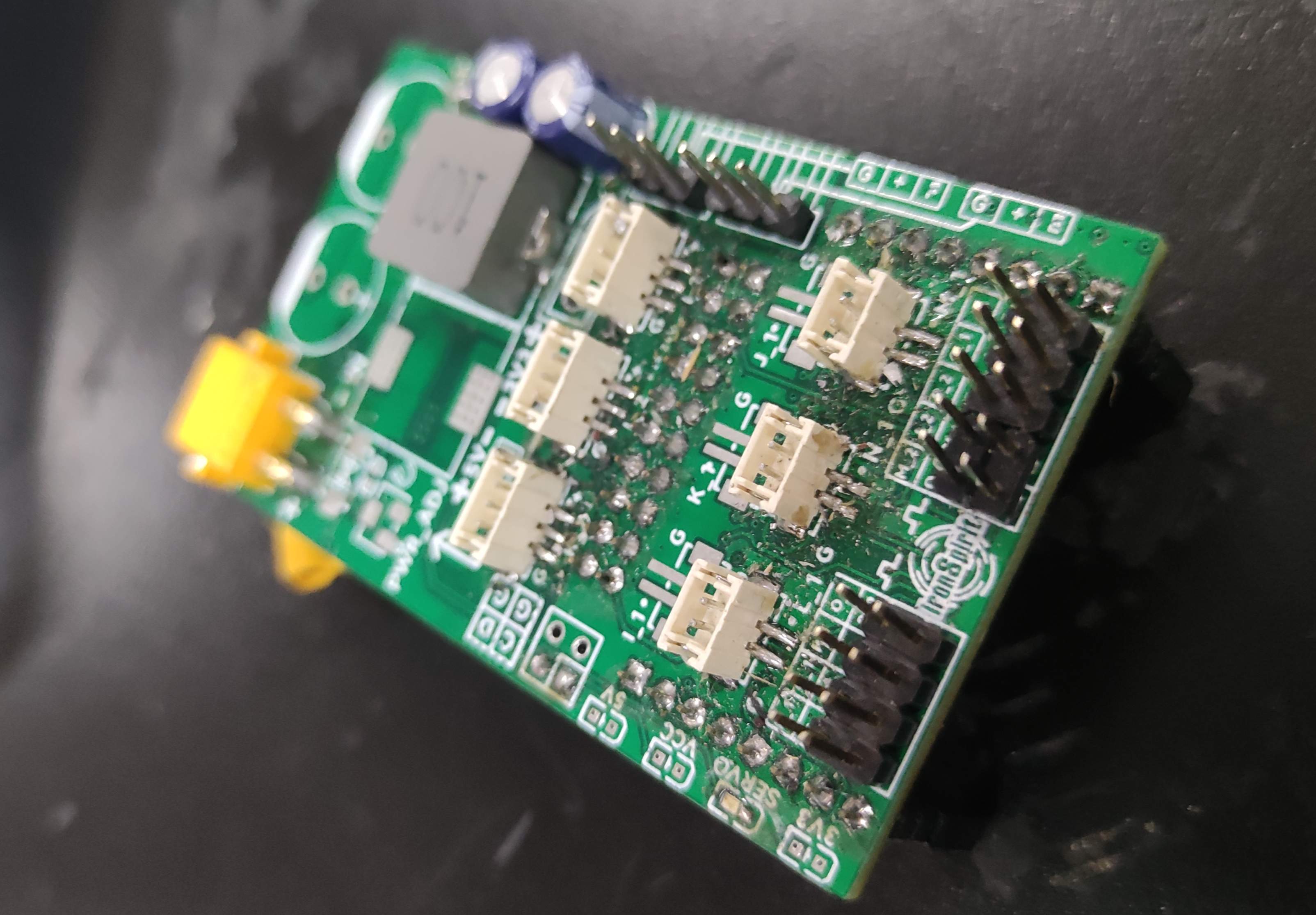

DJI A board extension expansion board
1. This board is an expansion board for the DJI A board. It is used to separate the power supply on the A board, lead out the commonly used IO ports, and provide protection. Buffer the input power supply before connecting it to the DJI A board for power supply. 2. There are two servo power supply interfaces on the board, the working voltage is 5V, and the working current is recommended to be less than 2A. There is also an adjustable power supply with an operating current of less than 5A. Two fixed output 5V and 3.3V power supplies are used for debugging.
3. The power supply is recommended to be less than 36V.
参考设计图片
