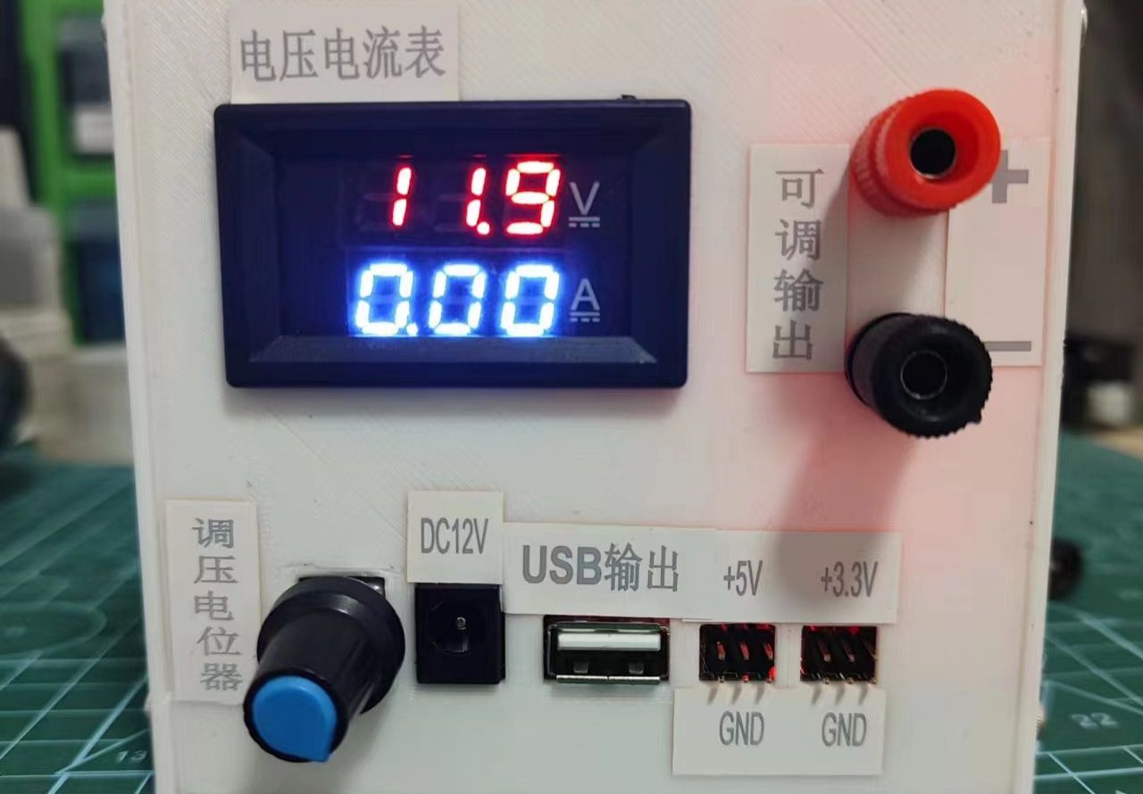

1. Introduction
This is a step-down adjustable power supply based on XL4016E1. It also has three commonly used voltage outputs: fixed 12V, 5V, and 3.3V, with a total of four outputs.

5. Pictures of the actual object
(1) PCB empty board diagram
(2) After soldering the board
(3) Adding a voltage ammeter
(4) Side
(5) After powering on
(6) Actual use of the actual object
(7) Voltage measurement
