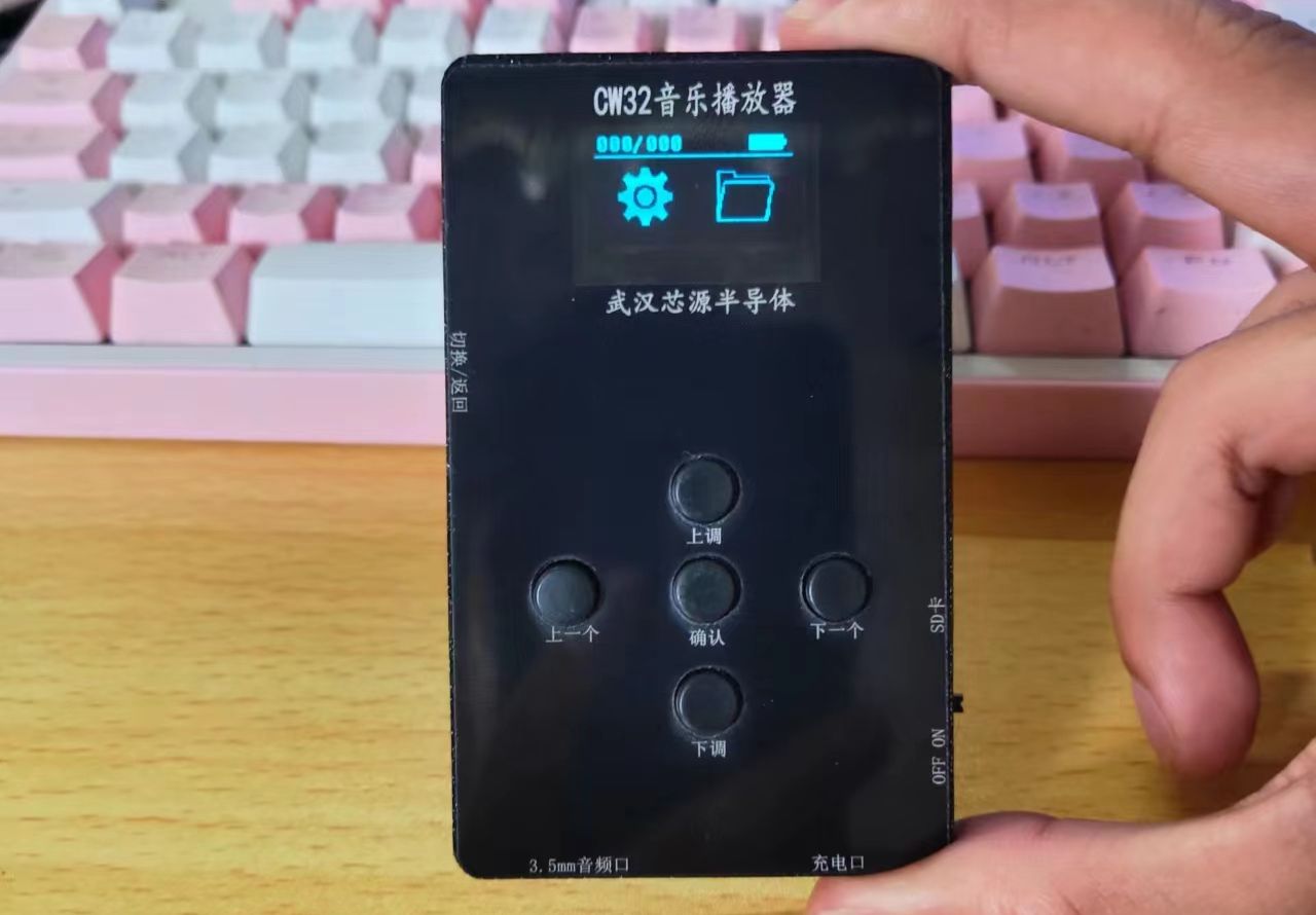

the physical display
design precautions
when it is turned on. We must be extra careful when installing the shell. Violent installation may damage the dial button!
