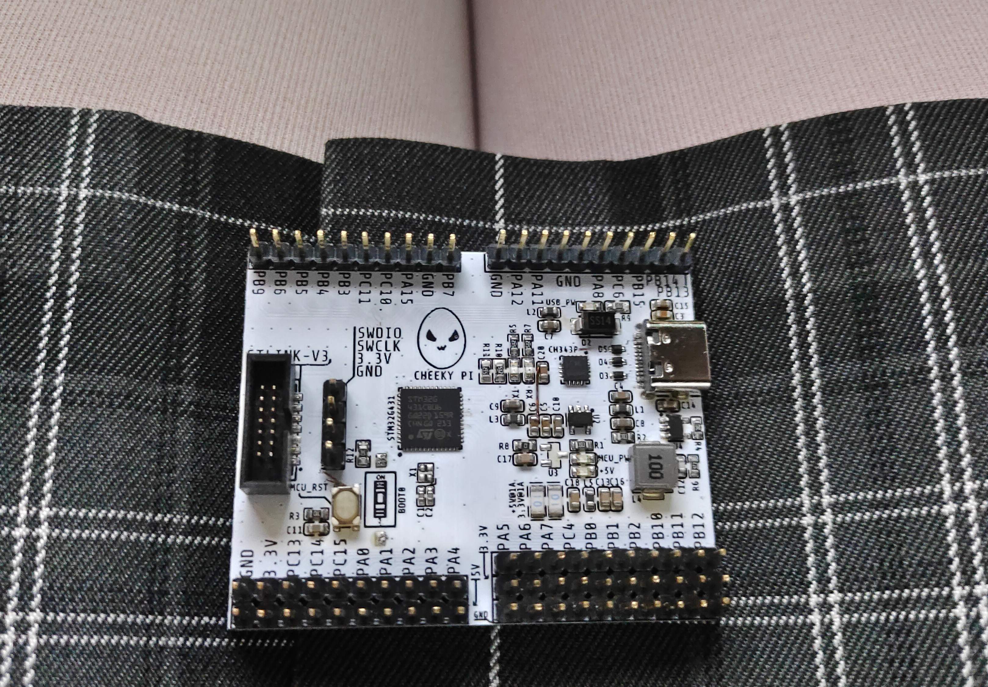

And the Bad Guy Pi has a variety of protection functions, such as protection against input backflow, ESD and power io overcurrent protection, and also has an on-board debugger and voltage reference source. The existence of these functions will greatly facilitate development work.
Function introductionInput
anti-backflow
ESD electrostatic protectionPCB
onboard serial port debuggerSTLINK
-V3 debugger interfaceSWD
debug interfaceBOOT0
switch and reset
button3.3V and 5V power supply IO fuse3.3V is provided by independent dc→dcDoes not affect MCU power
supply3.3V and 5V power supply ioLower left 5V Lower right GND Above GND are 3.3V
full IO leads (including but not limited to UART1 and SWD) 2.5V
voltage reference sourcePower
supply IO independent 3.3VDC→DCThe
above are all the features and functions of Bad Guy Pie
Actual photosWelding
processDirectly
brush solder on the steel meshDirectly
boil the iron plateDry
repair itTinn
power on testFuck big short circuitDirectly
scrape the bone to heal the wound (the error has been modified in the PCB)
Successfully connected
Why can't I downloadObserve that
the logic level of the WOC serial port is wrong and it is 5V (The error has been modified on the PCB)
I flew the wire and it works now.
