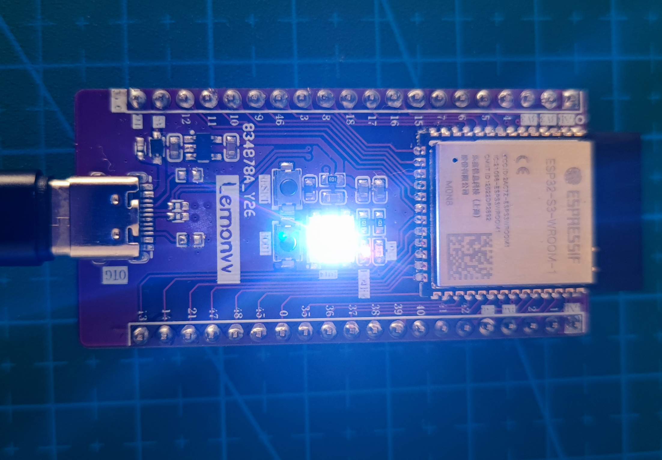

- **ESP32-S3-WROOM-1 development board, verified. **
- The reverse phase screen printing is overturned and the font is too blurry. The new PCB has removed the reverse phase display. If you think the font is small, you can modify it yourself.
- If the newly purchased module keeps restarting after powering on, you only need to download a normal firmware. You can download it directly through the USB port. After connecting to `USB`, it will automatically virtualize the serial port and `JTAG` for debugging. As shown below, when downloading, just select the corresponding `COM` port. If you keep restarting and cannot select the `COM` port, you need to press and hold the `BOOT` key, and then press the `RESET` key to manually enter the download mode to download the firmware. ![1663307570817.png] ---
- Comes with one LED light and one RGB light. No soldering is required. The rendering is as follows:
![IMG_20220916_131050.jpg] ![IMG_20220916_131853.jpg]
