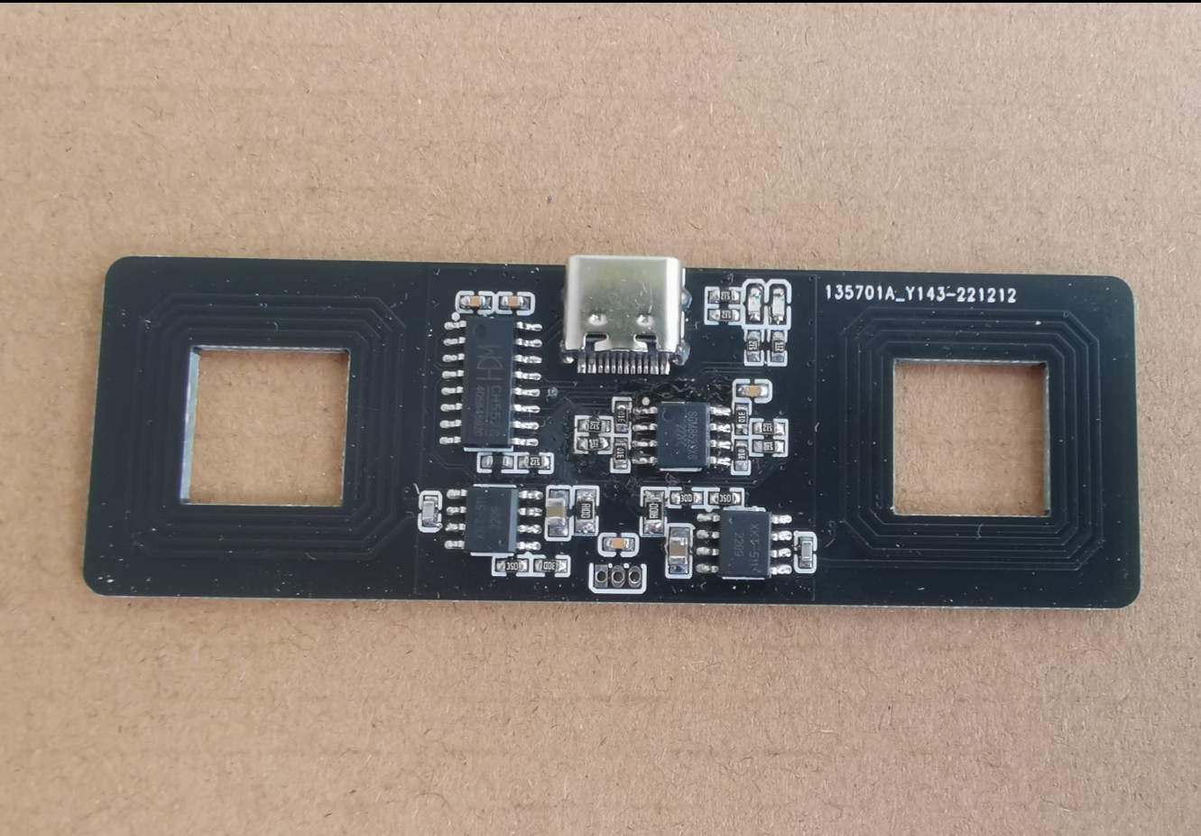

The wireless charger V1.0 used for my Elemental Dice is the charger that appears in [this video](https://www.bilibili.com/video/BV1Gs4y1t7k7/)
This is not the homepage of Elemental Dice, the project The homepage is at [Github: libc0607/GI_Dice](https://github.com/libc0607/GI_Dice)
This is a wireless charging transmitter using the XKT-511 solution. It mainly refers to
the measured resonant frequency of the XKT511-21 verification board ~940kHz , using 10uH and 2.2nF
in parallel on the receiving side, a CH552 can be added to the dual-channel charging to detect the charging current, the internal temperature of the charger and the cover status of the charger, but the codes for these have not been written x
double-layer board , the board thickness is 1.6mm, you can just buy it for free, there are no special process requirements.
Except for the two 10nF resonant capacitors that need to be made of C0G/NP0 material, the rest can refer to the component models in the schematic diagram
and the designed matching casing, and then the STL will be uploaded to Github
recommends using black oil because the painting is too ugly (sad
! [WeChat screenshot_20230228154810.png] ![WeChat screenshot_20230228154759.png] ![image.png] Open source protocol: [CERN-OHL-S v2]( https://ohwr.org/cern_ohl_s_v2.txt) or any later version
