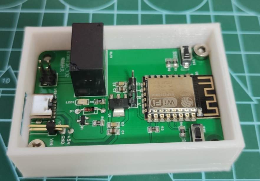

1. Introduction
This is an IoT remote computer startup module based on ESP12F. It can also be used as an intelligent switch to control the on and off of other electrical devices
. 2. Application scenarios
1. Desktop computer switch
2. LED light switch
3. Display switch
3. Product parameters
1. Input voltage 5V, can be powered by tepyc interface or DuPont line connection.
2. Output two sets of interfaces, retain the original switch function of the computer
4. Instructions
1. Make an IoT platform program and burn the firmware program to the module. (Take BFM Cloud as an example, refer to https://cloud.bemfa.com/docs/#/ for details)
2. Disassemble the desktop computer host.
3. Unplug the power button connection cable from the original connection and plug it into the relay interface of the module.
4. Take 2 female to female DuPont cables, plug one end into the other two interfaces of the module's relay, and the other end into the interface of the computer's original power button.
5. Take 2 male to female Dupont cables, plug the female end into the module vin power supply, and the male end into the computer's 5v standby power supply. The purple one is the 5v standby power supply, and the black one is the negative pole (pay attention to the positive and negative poles). You can also use an external tepyc interface for power supply. You can choose one of the two, but not both at the same time.
6. Supports adding to "Xiao Ai" control.
V. Actual pictures
(1) PCB empty board picture
(2) 3D effect picture
(3) Actual picture
(4) Assembly picture
(5) Actual wiring diagram
