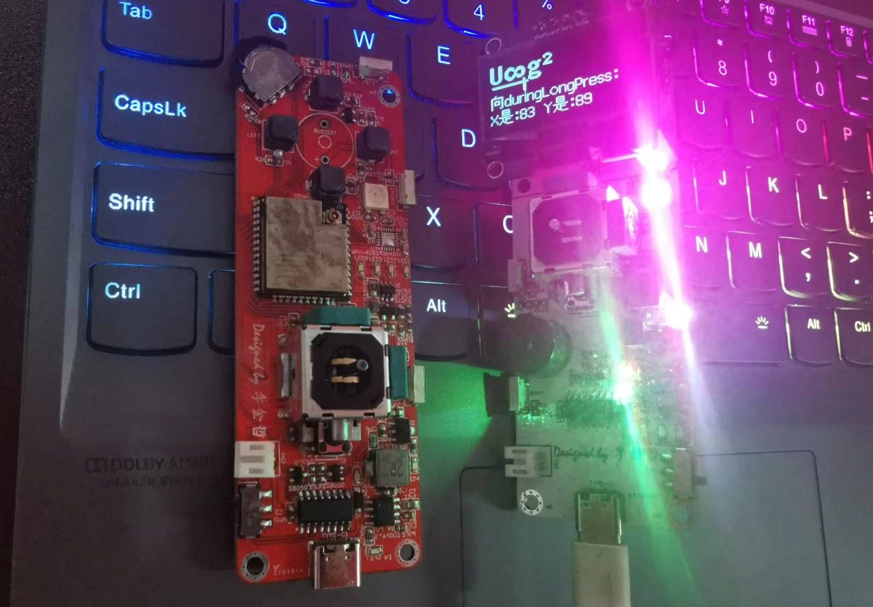

Fuhu one-handed joystick left
The one-handed joystick with gravity sensor will have a joystick, an MPU6050, a WS2812B, and an OLED screen. It will use a small pepper gain antenna for gain. A power management module will be added for charging management, using a 18650 battery. , that code determines whether it is left or right through the previous
// #define RIGHT_HAND_JOYSTICK // Use the pin macro definition of the right hand controller
#define LEFT_HAND_JOYSTICK // Use the pin macro definition of the left hand controller
